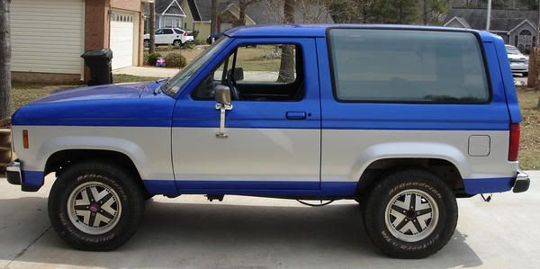

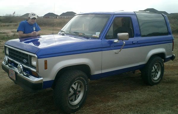

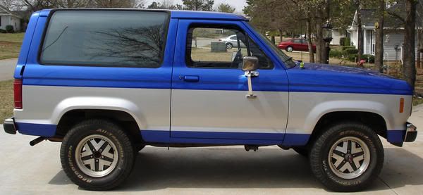

Yea...it's a Bronco II (like with the Ranger front end). It's totally stock...my parents bought it new in '87 when my mom was pregnant with me. Then they sold it to me for $300 in '03 or '04. I love my Bronco...I'll never get rid of it!
Pics:
My brother painted it once...this was the closest to the stock color...
He painted it again (this is its current state) after I wrecked the door on the driver's side.
That's me in the pictures...
