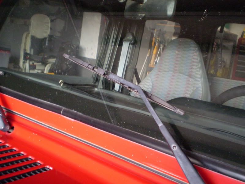

Since it seems that everyone is having trouble figuring out how to take the wipers off, I thought I'd do a little writeup for it. Pics included.
STEP 1: Lift the wiper off the glass.

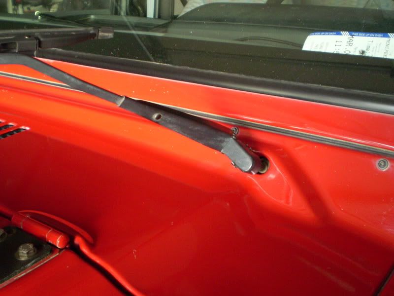

STEP 2: Find the tab.

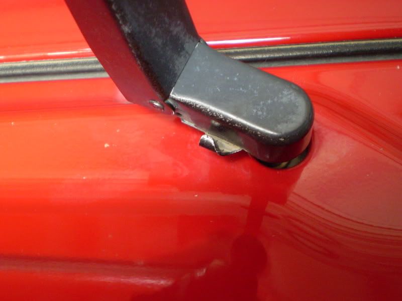

STEP 3: Using pliers or a flat screw driver, slide the tab down.

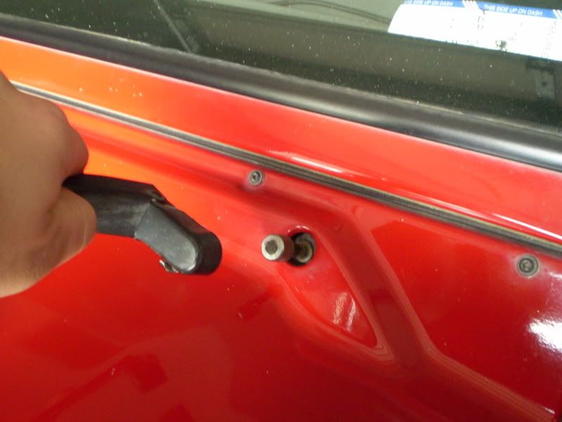

STEP 4: Pull the wiper arm away from the knob.
It's that easy!!!

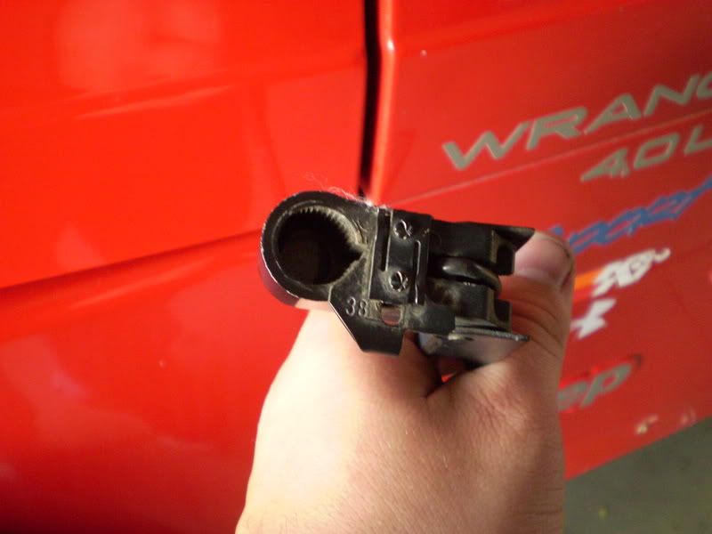

There are little ridges inside the arm, and the tab slides over the hole to keep it on the knob.

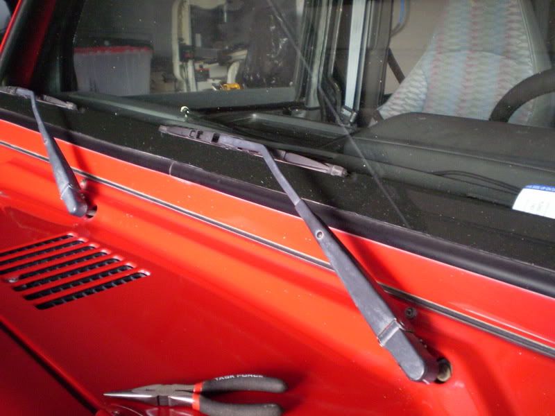

Be sure when you re-attach the arm to the knob that the wiper blade is horizontal.
Otherwise it will look like this:
