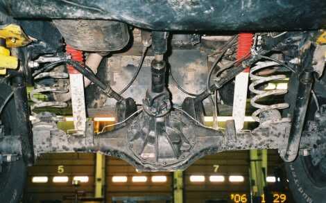

By who...and using what type of joint? I know there is a sa kit using clevite style bushings and a few radius arm kits but nothing using a jj......cant use em....need a self centering joint like the duroflex unit.
These work very well with JJ's.
The J arms don't get hung-up at all and their not self centering, they don't have to be. The sway bar was installed after that picture...

Doesn't look like a JJ.........one end has a clevite.....precisely my point. And that bend looks upside down.......
Nope. Google Currie J-arms.
Then you obviously don't know what you're talking about.
There are no clevite units on that axle...

Originally Posted by Knuckelhead
Then you don't know what you're talking about...
But, but, but he's never seen J-arms on the Metalcloak website...
Your shaft isn't long enough to handle that kind of droop...

Heck I've been trying to find someone selling a set for 4 years with no luck...
Those are now 8 years old and so are the JJ's installed in the axle ends, still tight as the day I installed them...
You did not specify any particular joint in your post... I know this is JF but surely you must know there are other choices beside JJ & clevite bushings. By the way a Duraflex joint is not JJ either.
Of course I do, but you need a joint or bushing that is self centering to get the job done. A downfall of JJ's is that they dont self center.
