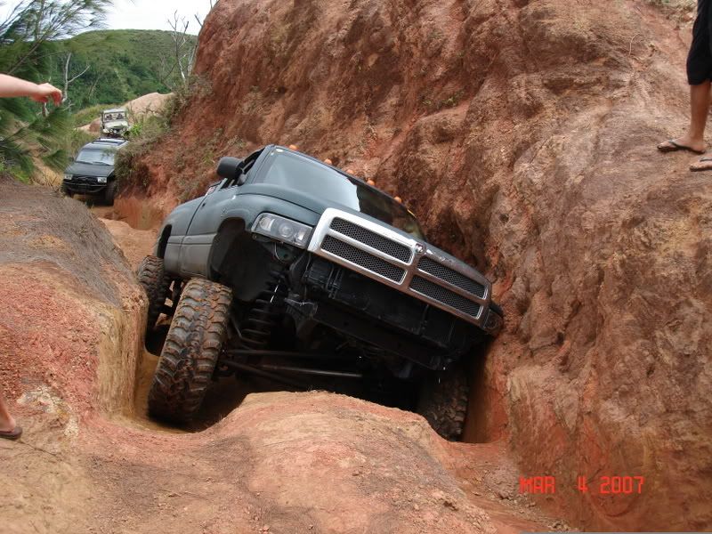

I went with the 9k only cause I wheel with this beast.When he gets stuck we have to use 4 vehicles as anchors and a snatch block

dawnskaybug, how much does that truck weigh? Just wondering.
