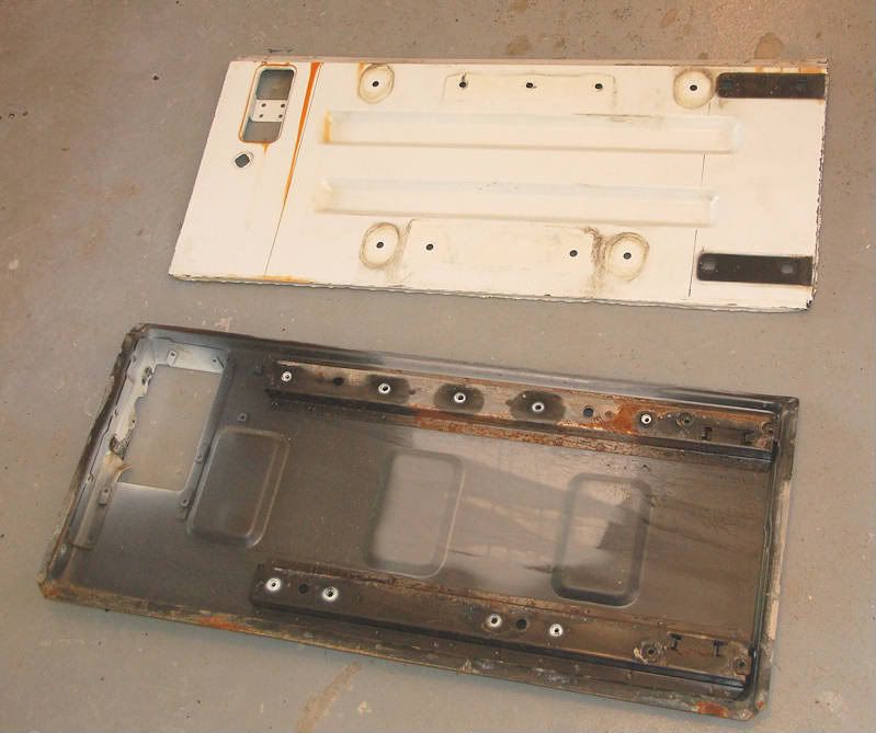

I have a YJ/early TJ tailgate apart right now, and I've got a spare 03-06 tailgate vent, so I just compared them for you. Without some tailgate modifications, the later model vent does not appear that it would fit in the earlier tailgate. The main reason is the center recess in the inside of the tailgate - that protrudes far enough into the tailgate that it would interfere with the back of the vent.
However, you need to provide a way for air to get through the inside wall of the tailgate, so if you removed that recess altogether and put a grille of some sort over the resulting hole, then the factory vent would probably have enough clearance to fit inside.
Also don't forget about the ribs on the outside of the tailgate, they will interfere with mounting the vent in the outer skin of the tailgate. Here's a photo showing the outer skin removed, you can see the recesses on the inside wall (sticking up in this photo) and the recessed ribs on the outer wall.
So yes it could be done, some some sheet metal surgery would be required.
