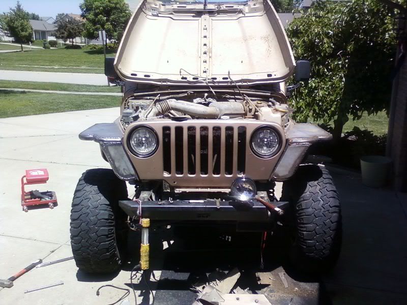

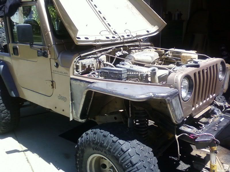

I've been wanting to cut my fenders for some time now and finally got around to it the other night. I decided to do it for 3 main reasons: 1) I like the flat fender look, but I don't really want to spend the $$ on getting "real" ones 2) I beat the crap out of my jeep and the front of the fenders were all dented in from my careless attitude about body damage and 3) I recently began folding in my fender flares on extreme flex to the point where they were always curled in and it looked funny to me. so I grabbed my jig saw and started cutting..........
I still have to mount my turn signals - going to go w/ the round CJ style on the grill under the headlights and there is still some touch-up to do plus add some black strip to the cut edges of the sheet metal for safety

Did you just cut the angular fender support? I trimmed the flares like yours the other night, haven't had time to do the fenders yet. I was looking at that support piece wondering how crucial it was to the integrity of the fender?

I notched it, keeping the support intact

im jw how you guys trimmed your fender flares. what tool did you use??

I used a jig saw with a fine tooth metal cutting blade then went over it with a file

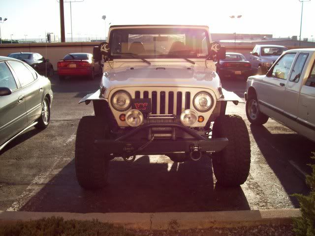

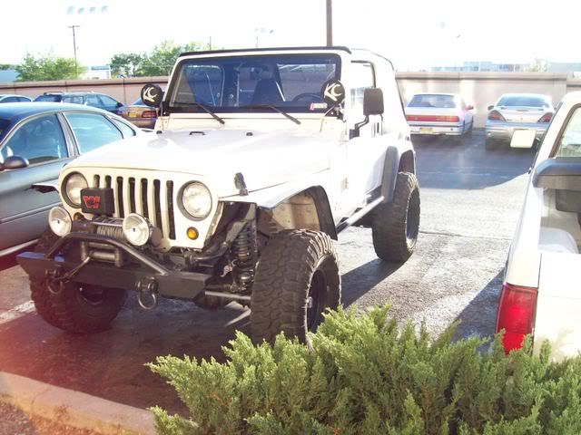

I used a 4 1/2" grinder w/ cutoff wheel for my fenders, and
flares. I added some of that door ding molding to the edges
so its not so rough. 2" Orange LEDs in the grill for signals.
