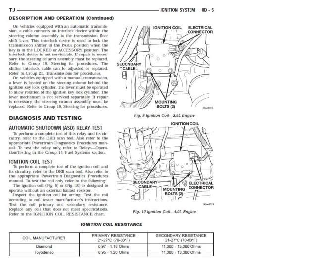

I know this is a little late but this is what the FSM says about testing the ignition coil.
Sorry if that's a little blurry, I'm at work right now and it's the best I can do on this crappy PC. I think I would agree with checking the cam position sensor next. Here is what the FSM says about that.
Hopefully that can help some. This sounds like an electrical issue for sure. If you don't have an FSM it might be a good time to get one.
