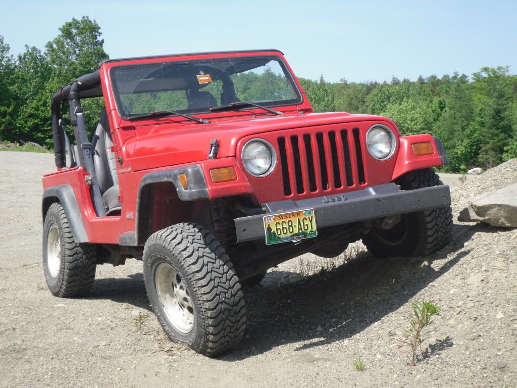

33's without a lift generally isn't a good idea. The LCOG rigs that do it on the stock suspension have significant modifications the body and drivetrain to allow the axles to articulate and increase the ground clearance.
On the stock suspension with no significant mods, those tires are going to rub going over speedbumps. Take the flares off if you want, but it's going to leave mounting holes exposed on the body, and generally look like ****.
If you want to get out and enjoy the outdoors with some light wheeling on stock suspension, you can't beat 31's. It gives a stock Jeep a nice off-road look, doesn't cause nearly as much power loss as 33's on stock gearing, and can clear the fenders and provide great articulation if you disconnect the front swaybar.
Honestly, an unmodified Jeep with be much more capable off-road with 31's then 33's.
Here's some pictures of my old TJ with 31's on stock suspension. I wheeled it all the time and loved it.
2006 LJ - 4.0L, NSG370, 31's
2001 XJ - 4.0L, AW4, 3.5" lift, 31's
1997 TJ - 2.5L, AX5, 2.5" lift, 32's - Sold

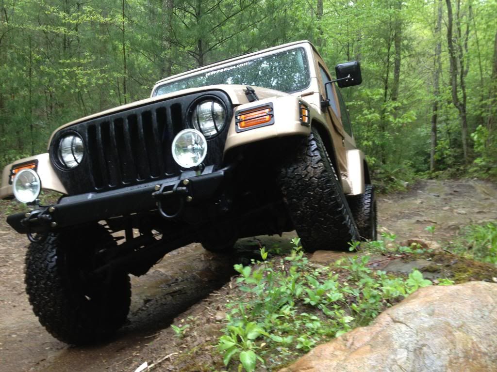

In all honesty you can get the tires to rub on 31s, and you could probably be just fine on the street with 33s all stock. I've run both.
33" Baja Claws 3.75 BS on MT mock locks.
This is when my Ruby was all stock, and I borrowed these wheels from another TJ we had.
I have pics of another jeep on 31s flexing in a very similar, albeit "harder" way. If you all really want pics I'll throw them on PB, but the reality is it rubs in nearly all the same places. Front flares on the furthest outside edge, especially when turning. Rear flares on the furthest outside edge, and top of the flare arch.
Look at the pics above and imagine more flex, and see where the tires will go.
