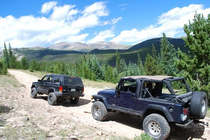

with the LJ, the 949s are the right choice w/ rear overhang, hard top, a heavy hitch bumper & spare tire. I carry a metric crapload of gear sometimes, and I installed airbags to compensate for the extra weight, and effectively increase spring rate even more. In the summer, I also drive around with a soft top and no gear in back....and I agree the 949s get stiff at that point. The 949s are rather short unloaded, but they don't unseat with OME's shocks, so it's not really an issue.
Sometimes I tow a trailer loaded with crap, and my Jeep is loaded with crap...and the airbags are pumped up to increase spring rate.
In this pic, theres is somewhere over 500lbs in back of the Jeep and a homemade rack full of firewood...it sank over 3" off ride height, airbags pumped up regained about 1".
But the next week, I can have a light Jeep, with a soft top on and no extra weight...so the rear sits a bit taller.
So basically, for an LJ:
If you have a soft top and not a lot of heavy crap on the rear end (bumper, tire carrier, steel gas tank skid, towing, etc)...then get 942s.
If you have a hard top, heavy crap, carry a load or passengers often....then get 949s.
As said, it's also not hard to change them out if you decide 942s or 949s is too little or too much. Also check out other rear spring manufacturers....somebody may offer something in between 160 lbs/in and 216 lbs/in with good unloaded lengths. Airbags can also let you adjust your spring rate a little bit as you increase load on the rear end....but they are high maintenance.
