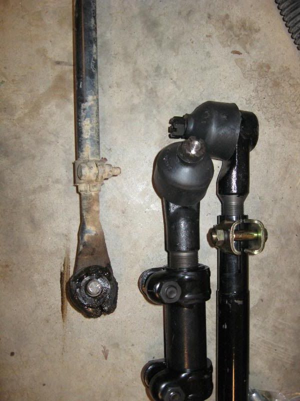

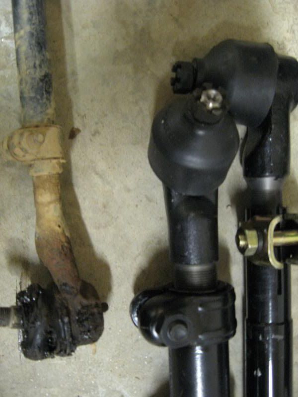

Old 11-28-2008, 11:57 PM   #4
Jeepster83
Location: Sacramento area
Posts: 2,424
i did the Currie HD steering and i love it. its MUCH bigger than the stock and keeps the stock geometry which is what you want. theres no need to ream the knuckles or anything since theyre the same size at the pert where it goes in the knuckle. the rest of the TRE's a much larger though.
one more thing. my drag link on the Currie HD kit is so big that i had to adjust the steering stop recently because it was rubbing my wheel weight. it rubbed a good amount of the lead off and now i have a slight wobble from about 40mph and up. i have stock Canyon wheels so your wheels may be different.

X3, Currie HD steering kit. 1.25" HEAVY tie rod, big tie rod ends, and a 1.25" drag link. Beefy and heavy as hell, you can't go wrong with it. I've been running mine 6-7 years now and it's been great.

X4 for Currie! What Jerry and Jeepster said
There is no comparison. The Currie system makes the stock system look like a joke. Pictures do no justice.
