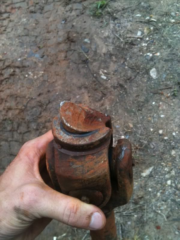

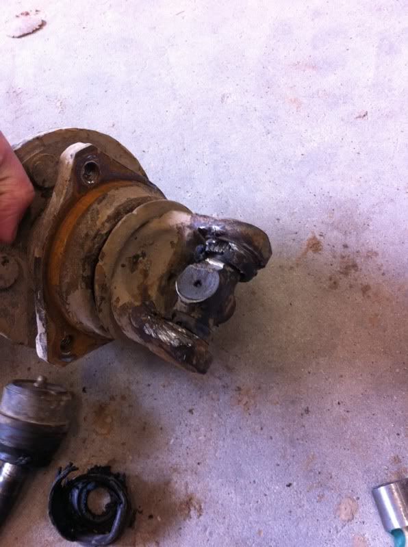

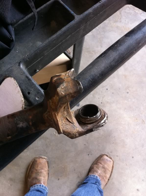

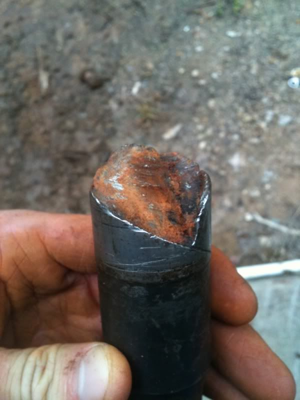

Dana 30 Detroit soft locker, Yukon shafts, spicer u-joints, 35" pitbull rockers. Doing a little snow wheeling and it got real bad. The locker was a little over two years old with a couple trips to Moab and several trips in the Elbe hills.

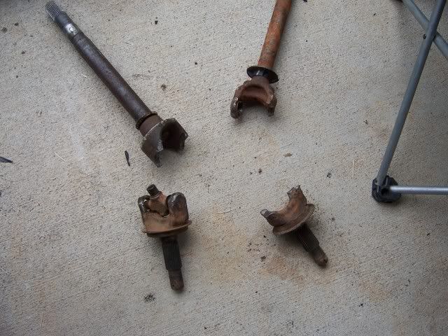

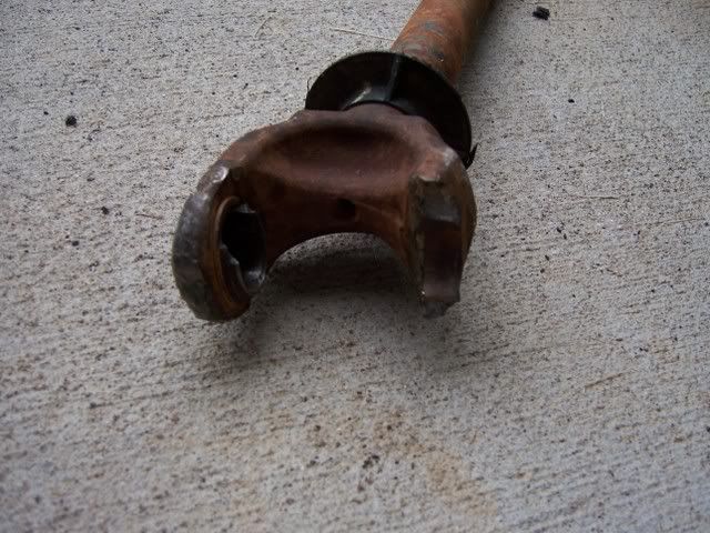

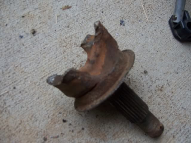

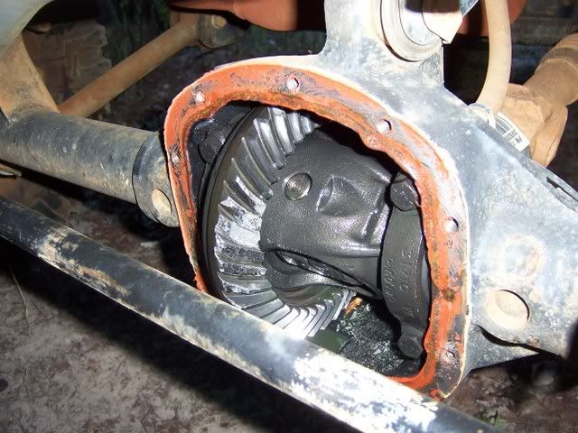

A few pics of my personal D30 failures
