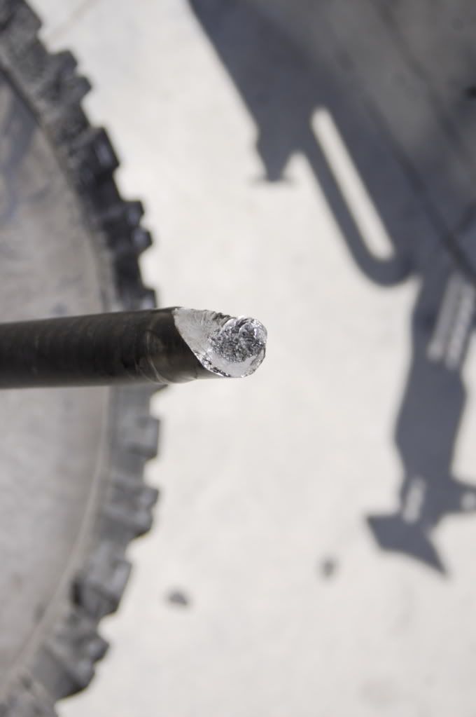

I broke a D35 shaft backing into a parking space in downtown. It would be easy to say I broke it on the street, but, it's apparent from the condition of the shaft that it had been damaged previously. That's it below
I've seen quite a few D30's twist the ears on the yokes, and twisted mine last year, strip teeth off the ring gear and break spiders. Actual broken shafts are not as common but does happen especially with 35" or larger tires.
