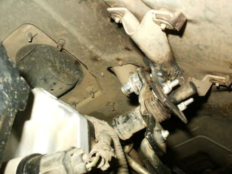

post #9 of 17 Old 04-17-2012, 08:06 AM
TheBoogieman
The Devil's Advocate
TheBoogieman's Avatar
Location: CharlottesHELL
Posts: 35,392
Originally Posted by Bannedone View Post
I did not do the lift, PO had it done... Not sure if the bracket was put on. It will be this weekend before I can do anything. Thanks for the help guys!
Look underneath for flat drop bracket pictured (under bad weld).
Originally Posted by jeepinmichguy_ View Post
TheBoogieman is a jerk.
TheBoogieman is offline

post #12 of 17 Old 04-17-2012, 09:17 AM Thread Starter
Bannedone
Location: Wears Valley
Posts: 30
Ok, I'll crawl under it and see what is under there. Thanks.

post #15 of 17 Old 04-18-2012, 06:33 AM Thread Starter
Bannedone
Posts: 30
Alright Boogieman, It has the plate and the linkage does not appear to be in bind or bent.
Search for adjustment procedures: Place in four low and the loosen the 13mm bolt at the shifter connection... Then what? Will it "force" itself in to the correct position or is there more I need to know and look for?
