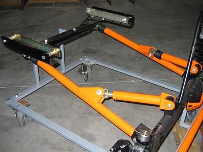

Ok so I understand how the radius rod mounts, but I don't understand why. In my under-educated mind it seems as if it would rip of CA mounts easier than a prom queen's dress. Also, was rear steer an issue? I tried to picture this in my mind and it seems like it would push and pull the axle forwards and back? I do believe I'm in over my head though.

Look at the upper arm and the bracket on the end...the single joint goes to the frame.
The two joints go onto the axle, and the single joint connects to the frame? Seems like it's upside down for that..
Is this another version of said radius rod?
This is what I first thought of when the subject arose. That to me seems like a plausible suspension setup. But the other one I guess is the same thing, almost.

Sundowner if their's anything I've seen looking at some of the work done on the Savvy jeeps and driving around in them.. Ride is more effected by spring and shocks as long as geometry isn't significantly altered. My lift is 2 months old I'm already ordering new shocks from Gerald today
Ignore list or not I'm curious on this because eventually I want to move away from a factory designed suspension. I'm trying to figure out if triangulated 4 link or triangulated 3 link or another option will be the right stuff. Sometimes thinking through the physics isn't enough you have to learn from others
Dale II thank you for the visual that's what I was looking at but something still seems missing..

Posts: 1,009
That's a radius arm set-up.

Posts: 1,503
This!
Looks good for something that doesn't have much suspension travel. But not on a long travel Jeep.
This!
Same thing I'm trying to understand other than it's strong enough to handle (I imagine I haven't real world experience but stock F350 is a similar setup) high speed impacts and heavy abuse.

i too am confused about the radius arm vs radius rod suspension theory
the only thing i can possibly guess is that having the convergence point further back (ie TBT in picture as opposed to a RE front) it would allow more torsional movement (flex) before the joints bind up?
Then again that is just my WAG

I've got my head wrapped around how it works, I think. Not sure about why it would be better or worse than a radius arm, though...seems like it's putting a lot of load on one area, though.

I think (I could be wrong) the geometry not only has to do with the ability to flex but also the direction the force is applied to the arms and the direction the force is transferred to the from from the arm. So some certain setups would tend to squat more than others under acceleration or torque left to right more etc. Maybe a smarter person can pop in on this.
