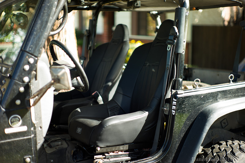

The side bolsters make entering and exiting the Jeep a little tougher but the extra support is well worth it.
Agreed.... Can't imagine running anything deeper on a DD rig. Wife hasn't given it a shot yet so that should be interesting when it happens
Looks like the seats I have (Twisted Stitch, APEX seats) have bolsters that are a bit higher. You do have to kind of "hop" out of them, but once you do it a few times it's easy. I was a little concerned about this as well, but after DDing my willys with these seats, I decided to get some for the TJ as well.
Once I mount them to the roll cage (I'll be working on the cage soon) they will be mounted a little bit lower, and leaned back a little bit more. Will be a more comfortable seating position, and will probably be a little bit easier to get in and out of. Though it's not difficult to get in an out as is. You just can't "slide" out of them like with the factory seats, you have to grab the roll cage and pull your self up and out. Sounds like alot of work, but once you do it a few times and figure it out, it's really no problem.
