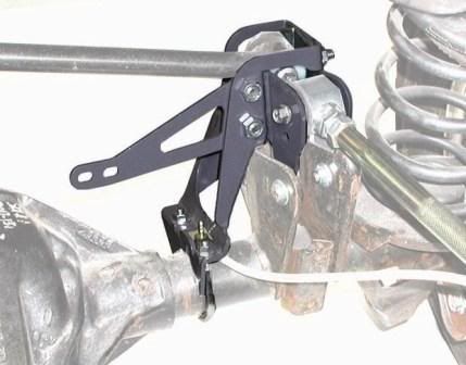

I'm not sure if this helps you, mrblaine, but I figured it couldn't hurt to post it.
Jay
Jay
Very nice, thanks.
