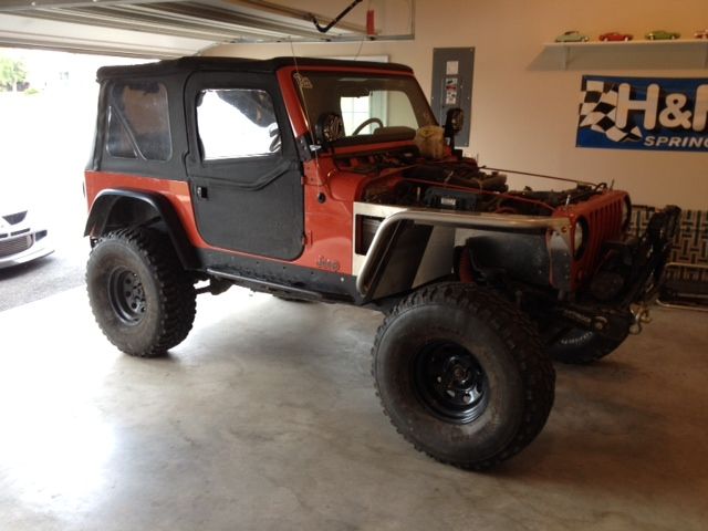

I'll have to snag a pic of the box in the daylight tomorrow. Till then here are some pics from Saturday. My 33" TrXus MTs were trashed so my buddy sold me some KM1s for $250 for the set! Like 70% tread on them. 35s and highlines now buddy!!!
Impact Orange FTW!!
Jeep is looking good and thats a sweet deal on the KM1s! 35's just look good and with the highlines the 33's would just have looked tiny. You're making lots of progress. It took me a lot longer than I anticipated, but thats pretty normal for my wrenching jobs. Nothing like an impact orange jeep!

Trimming the inners was not in my plan in the beginning, but in the end if you trim out around the shock/spring mounts it makes it real easy to put the fender on and pull it back off. I can pull a fender off in about 20 minutes now and install it in about the same amount of time. I have to say that I'm glad I went with the Genright inner fenders. They are really nice and make a clean finish.

Trimmed the inner to clear that thing. Does not look too bad. I have to take a hair more off around the coil/shock bracket and drill holes for all of the components yet. I somehow nailed it on the passenger side the first time. I also have to trim the front and redo 2 of the 3 slots horizontally on the outer fender where it bolts to the grill. I had to do that on the passenger side too. Man, those slots are not even close! Other than that fitment is great on the passenger side and pretty good on the driver. I wish the driver fit as good around the head light area as the passenger side. Oh well. I got tracking on the washer bottle and won't be here till Wed the 9th. If you get yours here soon please post up about it! Hopefully this weekend I can wrap up the fenders and cut and reinstall the stock hood. Next week I can get on the washer bottle and dealing with my rocker rivnut fiasco.
