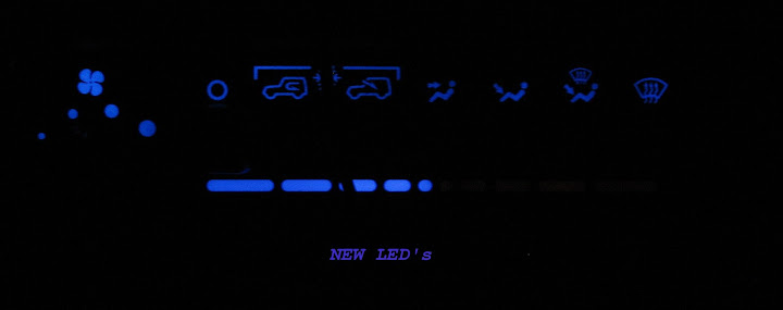

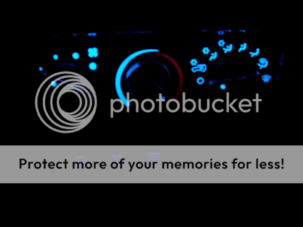

Originally Posted by 97TJdriver View Post
There ya go!! thats the jeepin attitude!
good luck with it, Oh btw i also threw in two of the same LEDs into the a/c-Heat control knobs and came up with this.. and they are the same bulbs since you wanted to know...
I wonder if i can change the bulbs in my stock cd player since those are the only green ones left.. although i do need a new head unit maybe ill go for one that puts out blue for the blue theme... lol
Why doesn't the right part of the temp slider light up?
Ill be honest I'm not even sure why its not showing in the picture but it does light up, obviously not as bright due to the faact that its dark red... But I see it fine.

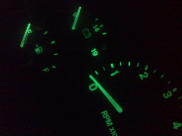

Originally Posted by BlackBellamy View Post
pics of green setup pls?
Cell phone picture of left side. One LED top right is not working so I just took picture of left side. Friend is ordering red ones soon so I may try to get brighter ones too. I lost ability to adjust brightness on my 1997.
Originally Posted by Keith_C View Post
Did you try turning the carrier 180 ??
The LEDs are polarity sensitive.
Yes I tried turning the LED 180 in the carrier, not correcting it. Might I have to turn the carrier going into its 'port' as well?
