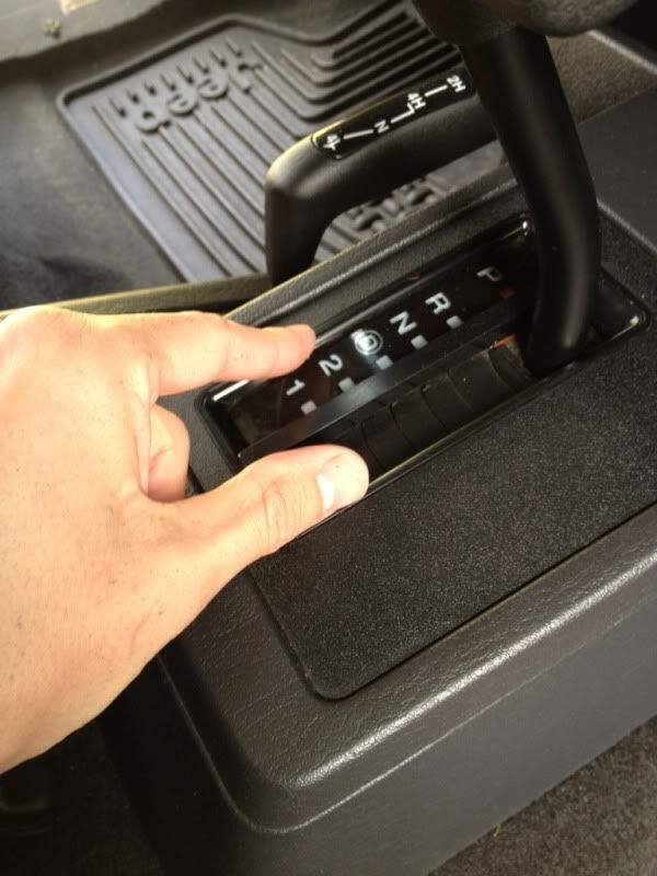

Question for the auto tranny guys....when I go to replace this bulb, does this whole piece come off?
or is it just this piece?
What's the best way to pry it off? I was gonna try a small flathead screwdriver

Put a finger in the track where the shifter slides, pull straight up. It's just a click in piece.

Thanks man! Only area I was confused about!
