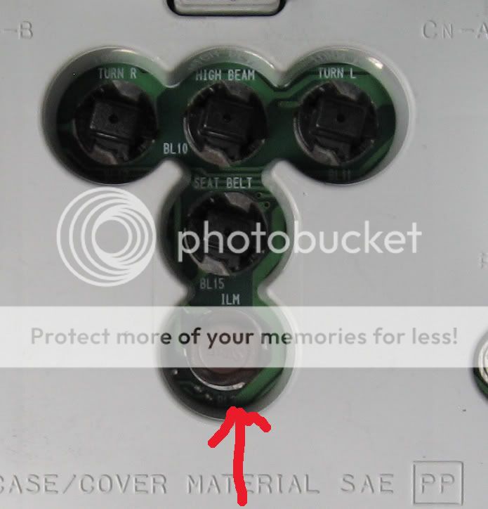

just to clear things up. the dash bulb number is 74. you will need 4 bulbs, 5 if you want to change your high beam indicator you can get whichever ones you want, single led, tri led, bajillion led. i personally think the tri led is brighter and better.
myrddin, those vleds you are looking at are sold in pairs, so the 6.99 ones are not that bad of a price.
not trying to argue with you but for mine you need five... and no the fifth is not for the high beams..
high beams is top one.. and the brown one is the fifth that i changed.. (correct me if im confused again)

So today I took my gauge cluster out to count the number of bulbs, and I need 5. I have a question though. In my 1992 Jeep Cherokee, the bulbs that are currently there don't actually light up from the back, they more put a glow around the edges. The bulbs also look to be bigger than the 74, I'm thinking like the 194?? So what bulb would you recommend? Any help would be greatly appreciated!
This is what my gauge clusters look like:
you probably are right, it has been awhile since i did this. i just remember i didn't change the high beam. so 5 it is!
