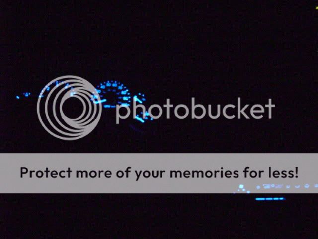

Ok, had a heck of a time getting these on photobucket for some reason.
Installed these about 3 days ago, they've worked well so far. And I used the same bulbs in the gauges as I did in the HVAC, but the lights that came out of the HVAC were different than the gauge lights, so don't worry about that.
If you need any other pics, feel free to ask.
Oh, and don't mind the left turn signal, that's something else that I need to fix (along with my resistor for the blower motor.)
