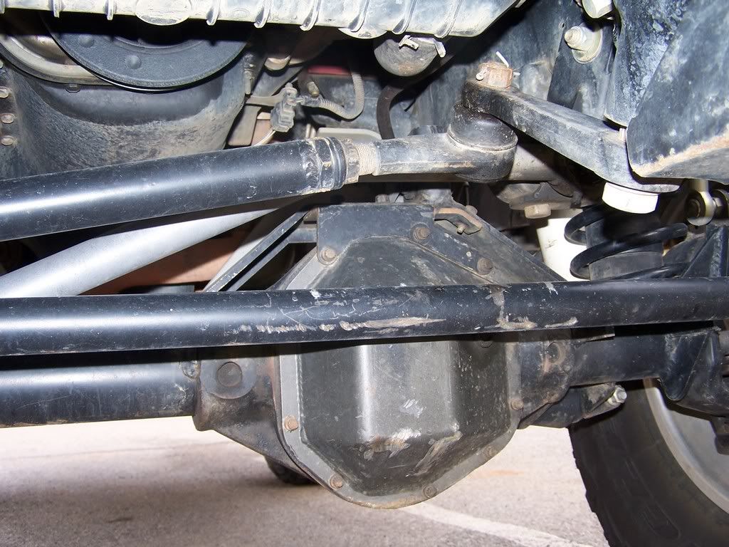

Yep G2 is the "house" brand for Crap wheel parts. You cant go wrong with the ones Unlimited04 mentioned, I have used these on 2 Dana 60's I've had and on my current Dana 44 and 8.8....never an issue and they do have the higher fill plugs http://www.bluetorchfab.com/Product/...ial-Cover.aspx
I know mine is on the front, but you can get an idea of the fill plug location (hiding behind my tie-rod). You would order the Ford one if you wanted the higher fill hole.
