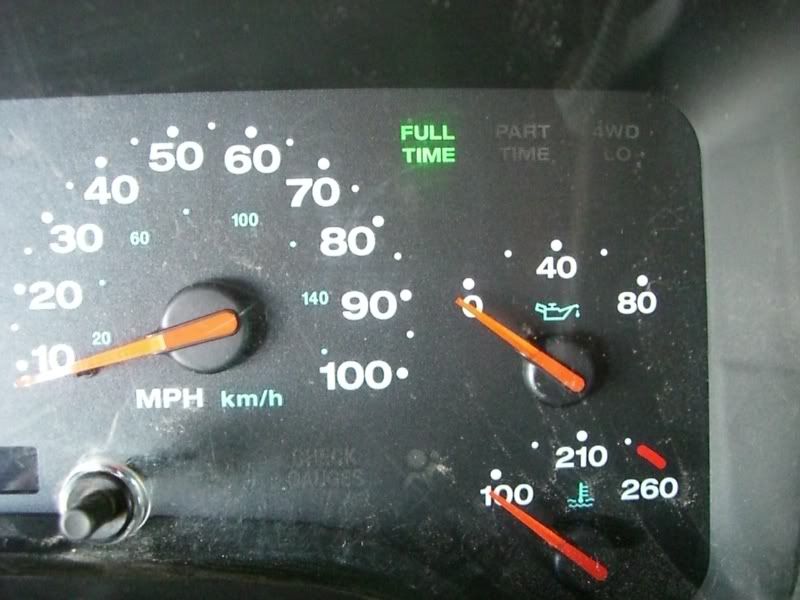

Originally Posted by Jerry Bransford View Post
The Full-Time indicator will never light in a Wrangler.
Never say never.
Once I get the 242 in there, I'll have to figure out how to get that lamp to light up when I shift it into fulltime. The above picture was taken during a gauge test where you hold the trip meter reset button while turning the ignition to "on."
Edit: It would be nice to have the "4 LO" lamp light up also when appropriate. Hmmm...
