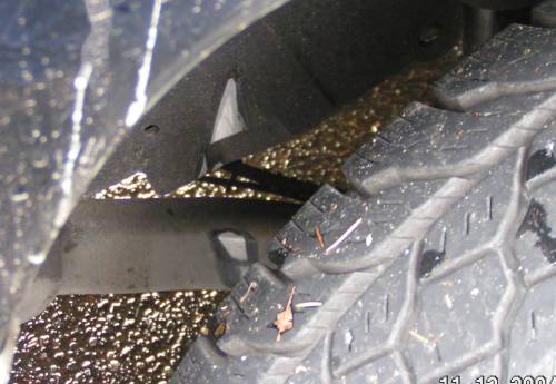

Posts: 4,293
Something like this perhaps?

Posts: 2,968
That looks like its rubbing. At full lock, when you move faster does the noise get faster? If so you will have to add a washer or two to your steering stops.
