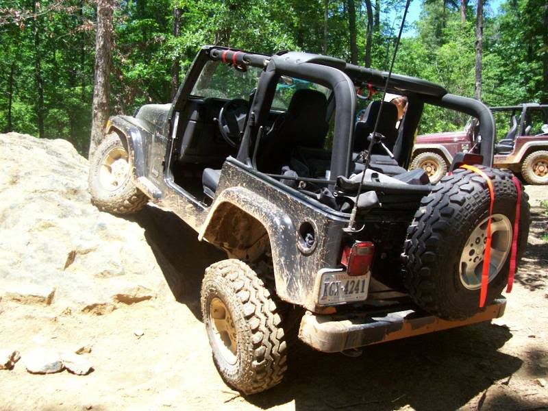

Best way (economical) to run 33's with not a bunch of wheeling.2.25"BB and 1"BL.Total cost with shocks is about $317 shipped.Nothing else needed.
3"HD springs/1"BL with 35's.Much more (not real expensive)stuff needed.
TheBoogieman is offline   Reply With Quote

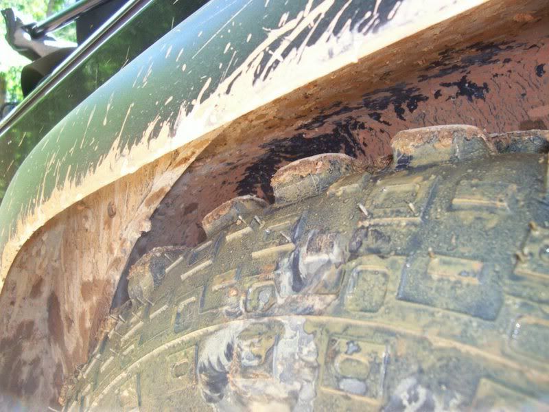

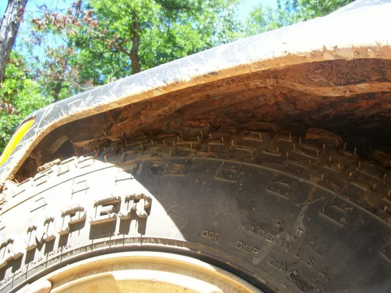

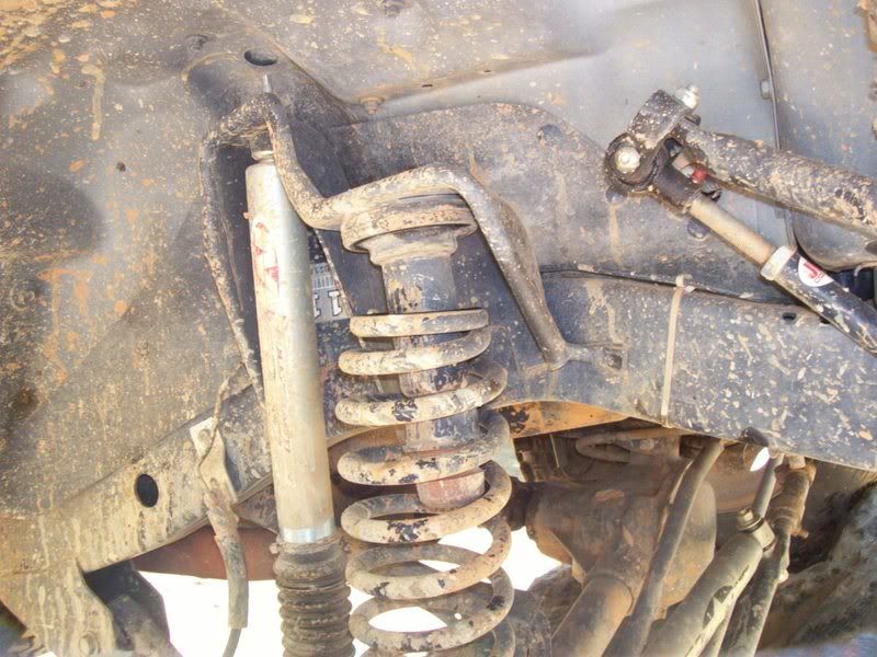

The 3" FT lift fits skinny 33" tires on stock wheels like it was meant to be.
I got nearly 4" of lift initially and it settled to about 3.5". It rides pretty darn good too, a tad rougher than stock but nothing bad at all. I've got the M-Force monotubes. I got them on sale at the time for the same price as the cheap FT shocks. I'll recommend those or Skyjacker Hydro shocks. I helped a buddy do a BB with those shocks and they ride really good.
I didn't need a SYE and all that jazz at first, I wheeled it a bit hard and bent my t-case output shaft which caused me to want to upgrade. From the way you say you'll be using it I'm sure it will be a non-issue.
Look closely at the above pic...
Here's where it is maxxed out on the bumpstops:
rear:
front:
I spent about $1250 for the lift and tires(not counting spare). Didn't need a BL or new wheels.
I chose the skinny tires on stock wheels since 33s are definitely not going to be on there forever.
I've got about 12k miles on the suspension and tires and it's all doing great.
