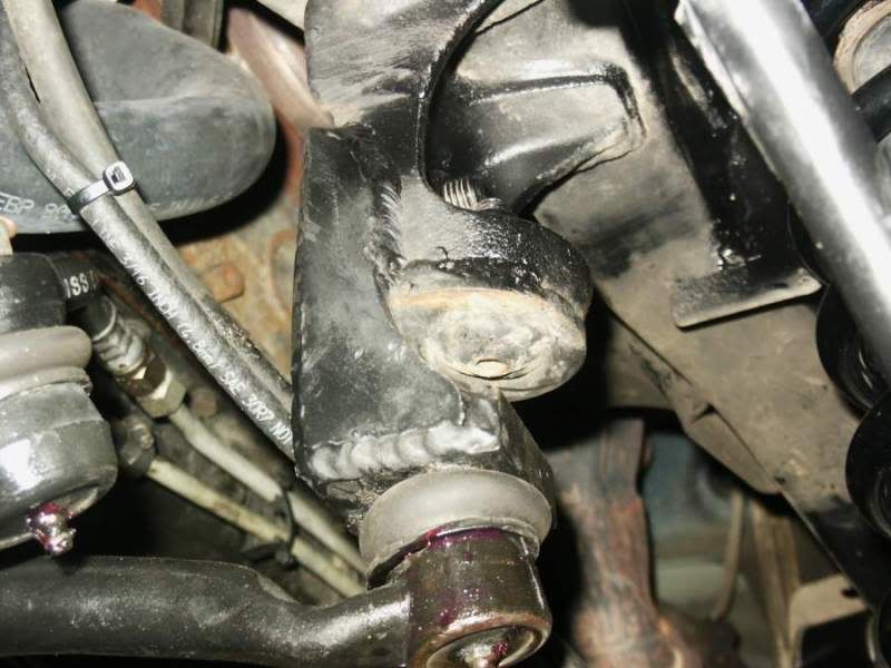

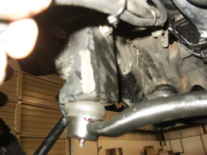

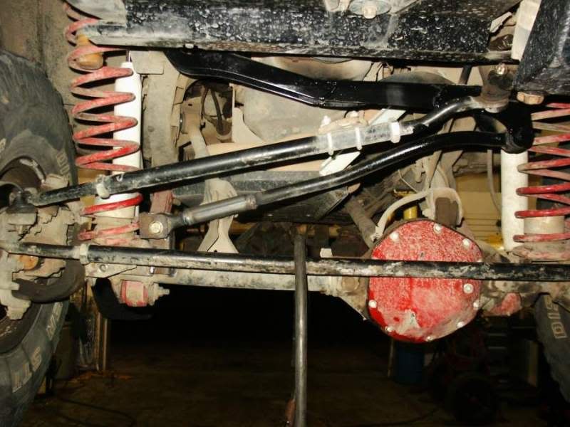

I just did a 4" Rough Country lift and it came with a relocation bracket for the front track bar. You have to drill two big a** holes in your frame (measure twice, cut once), but it works perfect-no DW. Looks close to the one in that pic.
