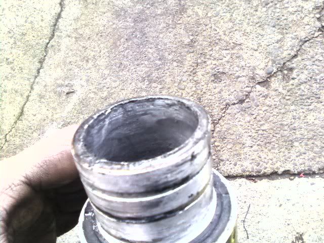

here's a little problem I have....
I just can't figure out why the outer seals keep going bad,
with brand new shafts.
clicky pic.
I'm not gonna reveal the brand.... I hope this will help get the problem fixed.
anyone else have a similiar situation? or maybe you do and just don't know it.

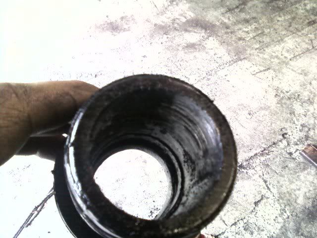

is that as you steer?
post up some high res of the inside of your tube seals.

lol, they are wasted......

let me guess. The wear is fore - aft in a horizontal plane.

kinda like a bent axle that just got the wrapper taken off of it, the tires never even got put on the ground with that pair in it...

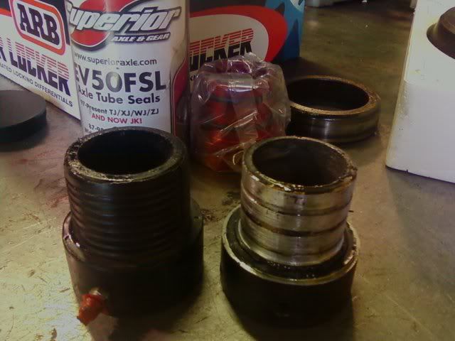

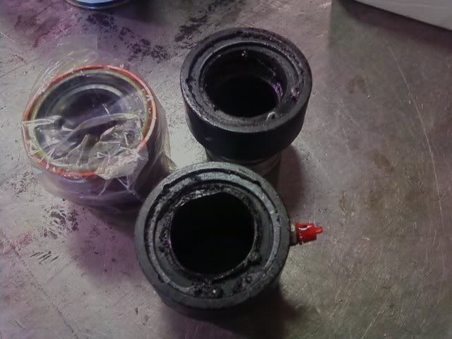

I've got word from the Brand, they are showing the manufacture the vid of the .150" runnout and are seeking a solution. I think it's a problem that not many, if any, have noticed after installation... it can cause a vibration and prolly throw u-joints prematurely besides dammaging outer axle seals.
it has been said, by the Brand, that .045" runnout is ok.... the stock ones have .003", hmmm...
but the seals won't last long, IMO if theres that much runnout I'd consider the shaft bent. which is how I found the problem in the first place, I though I bent them, untill the new replacements came which were worse.
