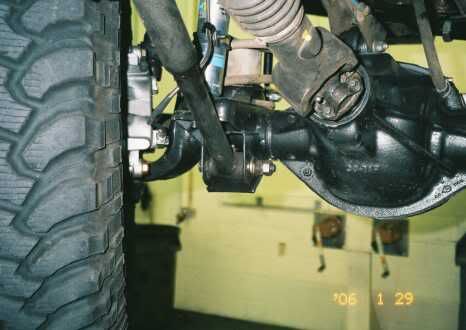

I don't remember how it was OEM, this is how I have it now...
