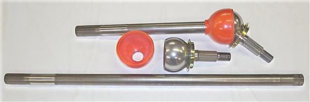

Front CV Axles for a rubicon. I got some.
I am getting the opportunity to test out some new CV Axles for the Rubicon.
They're made by Longfield Super Axles and if you know anything about Toyotas then you know he builds the best!
http://longfieldsuperaxles.com/
I am supposed to beat on these to try to break them. If they perform well they will go into production.
I'm getting them installed tomorrow. Pic's on my rig to follow.

Can you post some detailed pics of the CV joint?

I'd like to see pics of the backside of the knuckle to see how much grinding you had to do to get the boots to clear the bolts and bosses for them.

CV stands for Constant Velocity. Used in an axle application, they eliminate the drive and slack phases and uneven power delivery that u-joints have.
In general, smoother delivery of power is their greatest benefit.
The same thread is also at ROF and Longfield posted stating that they do require grinding on the knuckle to make fit. Pics will be posted soon, per the post.

these look great, but i think cost might be the only downfall.

Their site states the D60 version is $1950.00.

Im waiting for the pic's to come to me but I can tell you that breaking front axles in a shop is a blast
We tested a couple stock outers and some popular up graded outers and the CV and it was impressive on how much the CV's can take and the OEM ones cant take.
OEM tested at 10 deg. of twisting and 2000-2500 FT/LBS of torque before breaking.
Popular up-grade #1 tested at 40 deg. of twist and 5000 FT/LBS of torque
Popular up-grade #2 tested at 50 deg. of twist and 4100 FT/LBS of torque
CV's tested at 75 deg. of twist and 6800 FT/LBS of torque at a FULL TURN!!!!!!!
I cant wait to run these and not have to worry about breaking them(but trust me...I will try hard :lildevil: )
