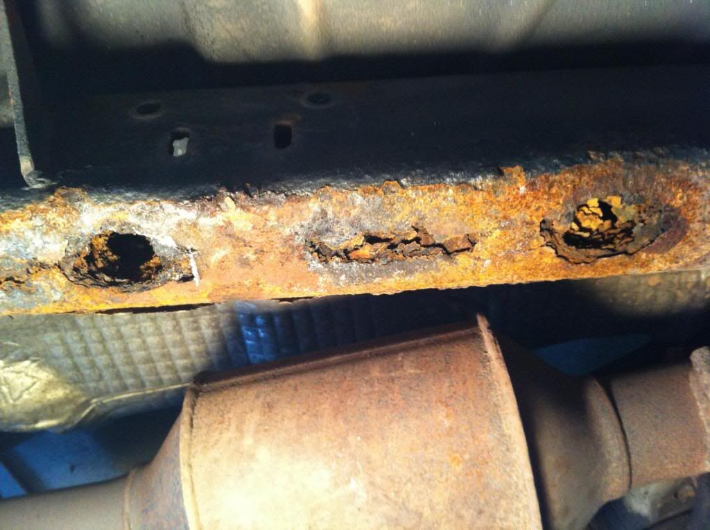

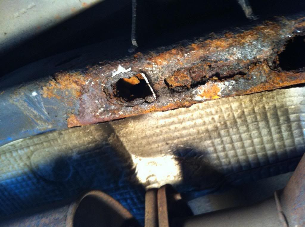

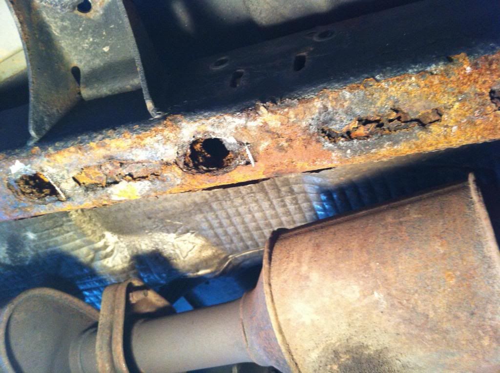

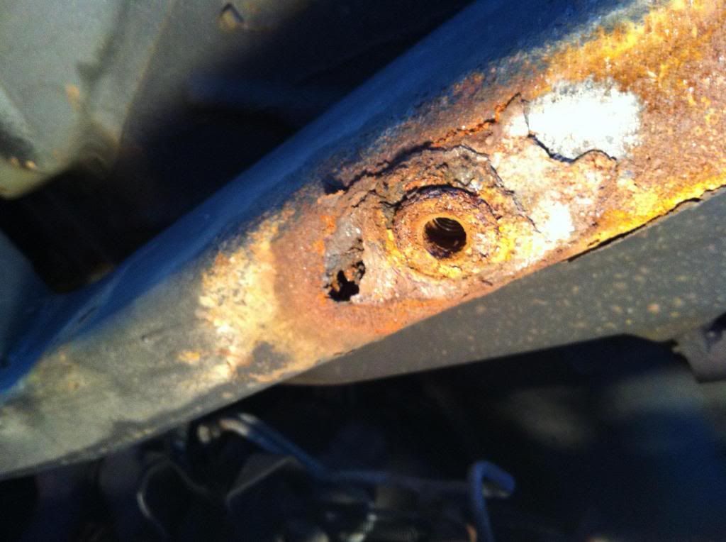

So I decided to take my skid plate off because I saw a nutsert hanging down a little farther than it should and low and behold, I found some good frame rot. Its a 2001 and has spent its life in the northeast. It has 155,000 miles on it. So what are my options?
I've heard of Safe-T-Caps and that seems like the best bet but opinions would be great.
The rest of the frame is in great shape and there seems to be only minor surface rust around the various holes in the frame.
I don't have a welder. I am mechanically inclined and can tackle a good amount of projects with some good instructions.
Thanks

You will want to hire a welder, a competent fabricator can build you a nice patch for the bottom of the rails. I would not tackle this as a first welding project. I can try to contact the welder I used to work with in Swansea, MA if you are interested, he has done a few of these exact repairs for me in the past.

Autorust is in Cranston. The make the safe t cap. Give them a call. I just did this project last week. Did a safe t cap on the passengers side, cleaned up the frame and painted. Cut all of the rot out and weld on a cap, make sure you get all of the bad metal.

Before doing anything, get a fiber optic camera, fish it into the frame in various holes, and inspect. Take a small 4oz ball peen hammer and tap the frame everywhere, listening for the clean sound of intact metal or the muffled clunk of rust. If the hammer makes a hole, that spot is already gone. Now make YOUR decision on complete information about YOUR frame condition, not just a hopeful guess. Jeep frames rot from the inside out, and the appearance of the frame exterior is not informative about the true condition.
If YOU decide it is salvageable, fix it. DON'T ask anybody else's online opinion, because those are ALWAYS colored by their own opinions with their own Jeeps, which have absolutely nothing whatsoever to do with the real condition of YOUR Jeep, about which other people in an Internet Forum know nothing whatsoever.
Make YOUR decision and take responsibility for your choice. Don't ever take any input unless that person is present and evaluating the precise condition of YOUR Jeep.
In truth, the welded-on frame patches are a temporary, rather expensive fix that promotes more rust. They are strongly advocated by repair shops and welders who personally profit from such repairs.

Just an update in case someone stumbles upon this, I ended up taking my jeep to Auto Rust Technicians in Cranston RI. I asked around at a bunch of shops in the area and they all said to go to Cranston. So I dropped it off and two days later I picked it up. It looks awesome. The welded in sections look great. The skid plate bolts right up with no issues. They also painted my entire frame. Yes, it was expensive but now I hope I don't have to worry about my frame for awhile. I highly recommend taking your jeep to Auto Rust Technicians if you have any frame rot, as they did an excellent job.
