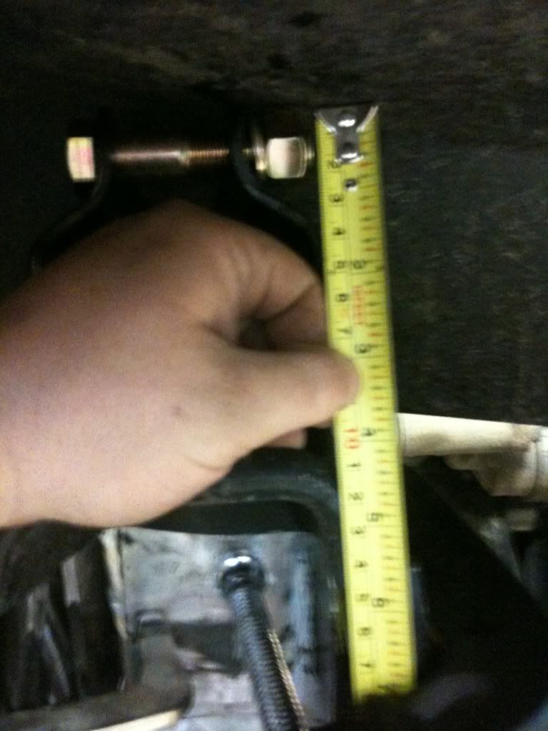

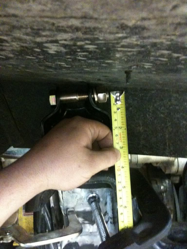

I did this the other day so I could take advantage of the droop I have available. I hope it helps someone, it's super easy. I already had the towers, so I used them. You could just as easily cut a 4" piece of steel, bend it into place and re-use the factory mount if you like. My new shocks had an eyelet at the top so this worked out best for me. These are 13.50 each from a ford dealership, and te part number is readily available in several other threads on here. Sorry, I don't have it on hand to give. I only had my cell phone on me when I was doing these. Enjoy.
Marking the stock mount...
Here I cut the top off, and just took a BFH and beat the ford mount into the hole trying to get an idea...
Two of these because I didn't know if the tape would show up well enough in either... If you can't tell, it's about a 4.5" difference.
