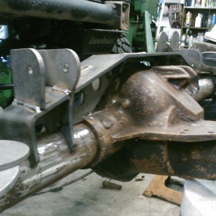

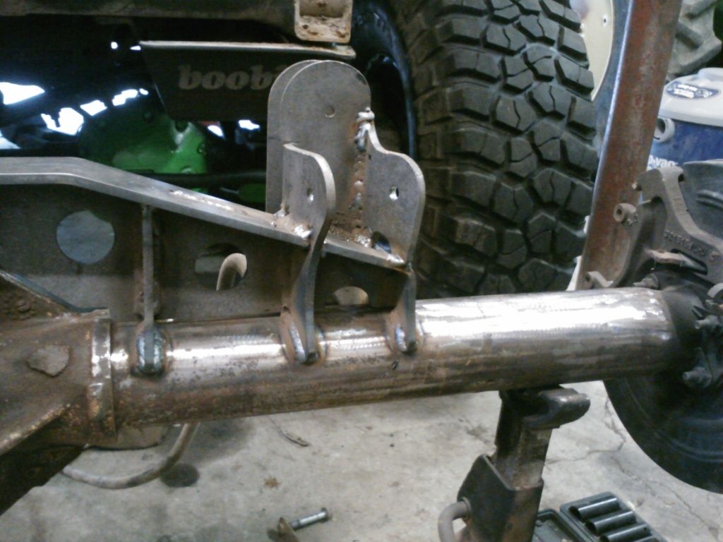

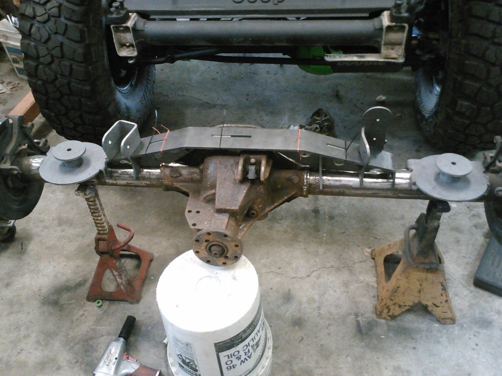

post #27 of 67 Old 06-24-2012, 03:56 PM Thread Starter
freeskier93
Location: Highlands Ranch
Posts: 7,242
Whew, finally finished getting the brackets off this morning. Took less than 10 min to cut them off but took a lot of grinding to smooth it out. I then loosely put the truss together and set it on the axle to see how it looked. I discovered a good friend who lived in the neighborhood has a 220v mig welder and he said I could use it any time. I'm going to get it this week so I can practice then this next weekend tack the truss on. I figured I'd rather use a mig welder than trying to mess with the stick welder.
