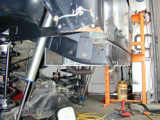

That's not a flat skid.
This is a flat skid-
mrblaine is offline   Reply With Quote

Originally Posted by red99tj
its alot flatter than the stock skid....i gave him a suggestion.....
(at least show a pic of a t-case skid, not a gas tank skid )

Posts: 1,458
Yes Sir that is one flat skid!!!! 3/8 in Alum or steel? Did you have to modify the tub to fit Tcase or linkage?
