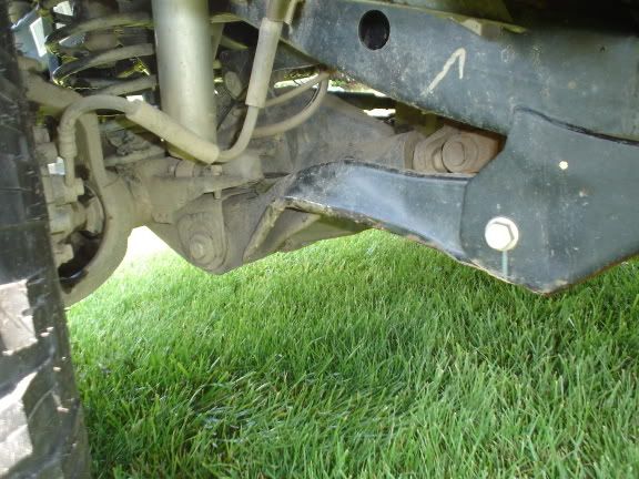

He's talking about ones with poly bushings, ones like these:
You can plainly see here there is no room for flex because the poly bushings just don't flex very well. All the force is transferred to your mounts. The stock ones are rubber and they are U-shaped, so they will flex way more than these above.
IMHO, if you're not going to get ones with a flex or johnny-joint (on one end at least), you should stick with the stockers. I run Curries (below) and can't be happier. Spensive though!
