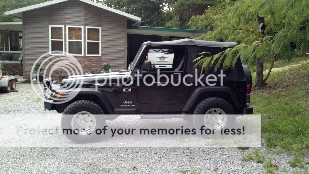

hey guys, i just finished my install of my smittybilt bumper and winch. afterwards i noticed i dramatic droop in the front end. i have measured it out to about 2.00 inches lower than the rear wheels. im thinking of going with a local company here in knoxville and using spacers. the company ,top gun customz, manufactures them in house out of laser cut steel and they seem legit enough.
this means that the front had drooped about 3/4 of a inch lower than stock. making it 2 inches lower that the rear, i want to level everything out. (sorry ment to at that)
questions:
will a spacer lift be ok in my application even with the extra load on the front
should i look into shocks as well while im there
do any of you guys have past experiences with tgc and if so is it really to quality that they state
im not hardcore off roader by any stretch, me and some friends like to hit up light trails, sand mines, and hard to get to hunting and fishing spots.
i think that covers all of it. oh and heres a realy bad pic of the after result.
thanks guys

any thoughts on how to tell if the springs are bad? oh and the bumper and winch weighs about 110 pounds. the bumper brought down the front end a total of .75 of a inch from stock, and i figured that while im in there i would go ahead and make it level with the rear. any way thanks for the quick reply, ill go to top gun tomorrow

no no no. the front only dropped .75 of a inch. and the ride height is stock so the front is 2.00 inches lower that the back. sorry ment to add that

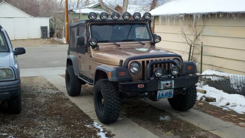

1" spacers will work fine.I prefer the poly spacers over aluminum.Here's my brother's jeep with 75lb bumper and heavy winch with 1" spacers I installed.

called up top gun customs and got a set of 1.75 spacers and brought the nose right up to level with the rear. this will do just fine until i wear out the tires and go with bigger tires.
