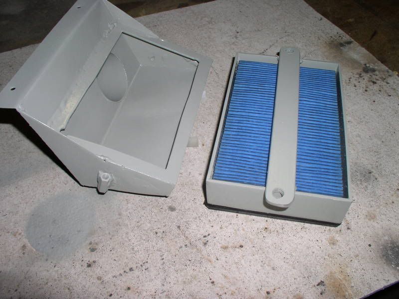

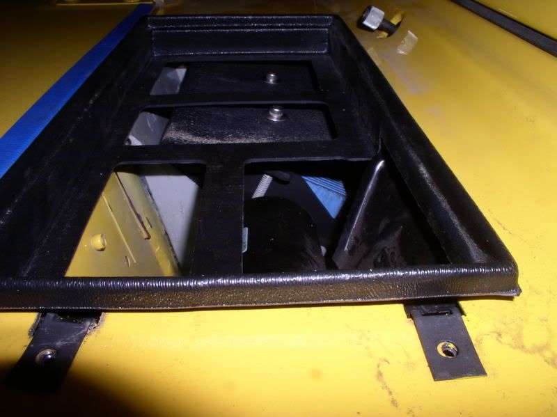

FYI The CAI I use is now available to the public.
YouTube - MCAI First Look
I have the first design which uses a metal tube.
My secondary filter also looks a little different.
This is who sells them.
Skinny Pedal Products
Double filtered engine air, filtered cab air, better mileage and performance.

You finally got them on the market heh? Has been a long time in R&D.
Nice!
BTW, my cowl CAI with OEM air box and filter is still doing what I want it to.

what kind of filters will the MCAI use?

nicely done!
got any pics with the cowl off?

Pretty sweet. I like the idea of the prefilter, though I wonder how it'll work with dust and mud getting on it and such. Maybe wrapping the prefilter in pantyhose or something might be a good idea?
$350, though? Really? Are there at least any real-world miles on that setup with oil analysis showing silica levels and such? Any dyno runs or meticulously logged mileage numbers (without a change in driving habits/styles, of course)? I mean, I like the idea, and I don't want to be sold a pack of marketing lies, especially for that price, but I think I could maybe be talked into it...
