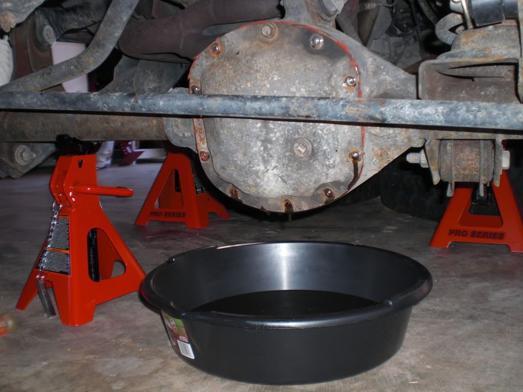

So I'm finally getting started. The project - quick reminder - is to regear the patient to 4.10 from 3.07. Install an S35 kit, w/ Ox locker. I decided to start with the front axle. The theory being: the setup on the front is less critical and I will, presumably, be more skilled when I get to the back.
So I'm gonna proceed in baby steps, which may be quite boring for many; my apologies in advance.

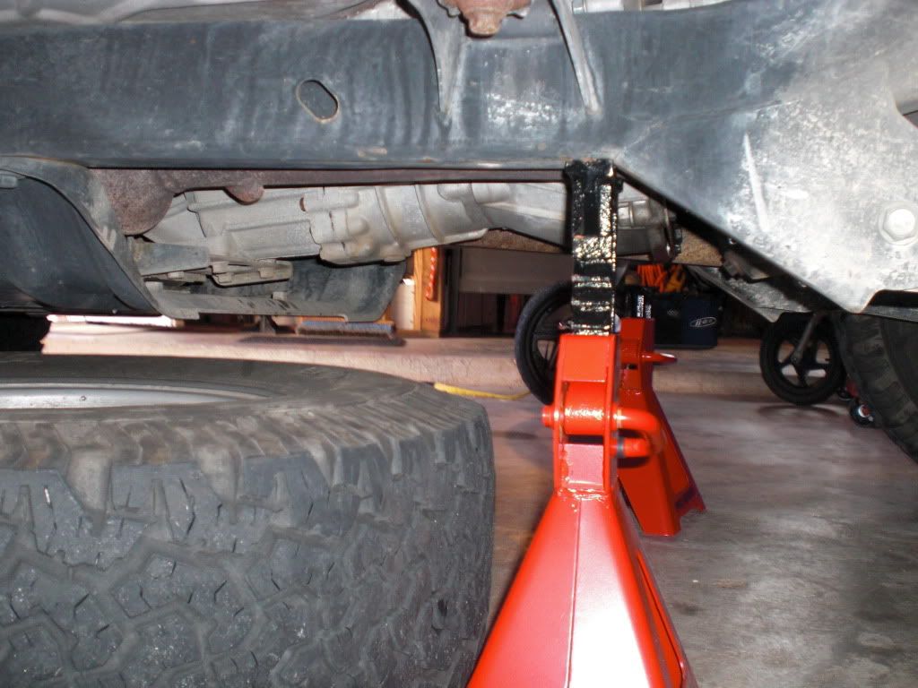

First step is to jack up the jeep, put it on jackstands, remove the wheels, and place them under the jeep. I put the jackstands just behind the control arm, like so - I think that's the correct place. Notice the wheels sit beneath the shovel. Death by jeep is something I desperately want to avoid.
By the way, I place my floor jack on my axle in the little pocker formed by the lower control arm, which seems like a secure location.
Every operating room needs music. I prefer Last Train Home, Foo Fighters, and a littel Stoney Larue - your tastes may vary.
I pulled all the bolts off the front diff cover save one which I only lossened. I beat the cover loose with a large screwdriver and hammer and let the fluid drain out. Later I took it all the way off.

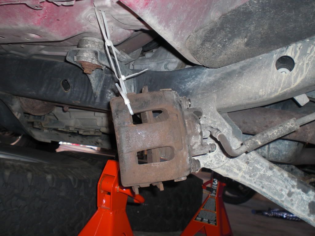

I removed the Shocks and the brakes and the rotors. I zip ties the brakes out of the way (there has to be a better way, but that's what I came up with - see pic). One of my rotors was reluctant - I beat it more than a little with a BFH and it eventually came free.

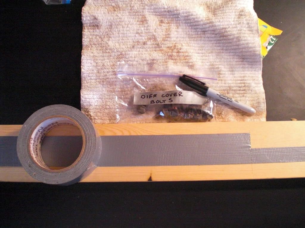

I'm keen on avoiding Humpty Dumpty syndrome - I want all the pieces to actually go back together again. So, I invested in ziplock baggies, and made a little labeling station. I place my pieces in ziplocks, write a label on duct tape that I've laid out on a 1X4, cut the label out with a utility knife, apply the label. Then I put the ziplock in a safe place. I hope this works.

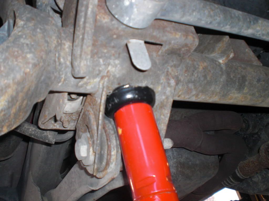

At this point my quick disconnects make removing the sway bar links a breeze. I zip tie mine out of the way because I wasn't willing to drill and tap the frame to install the neat little JKS disco keepers.

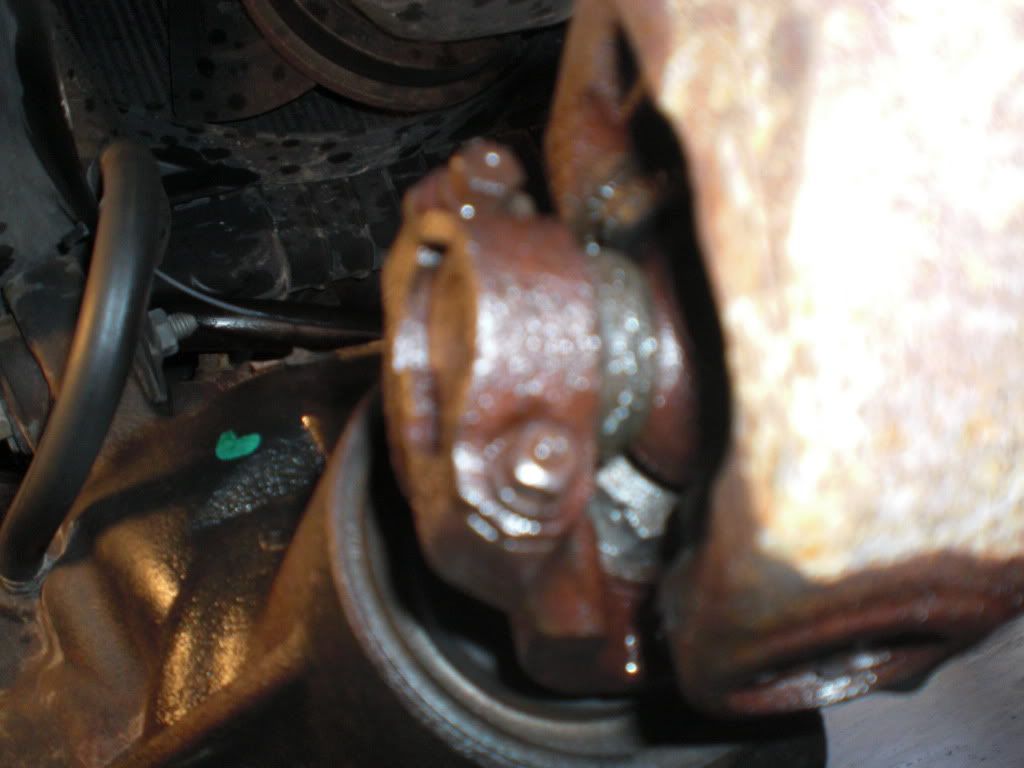

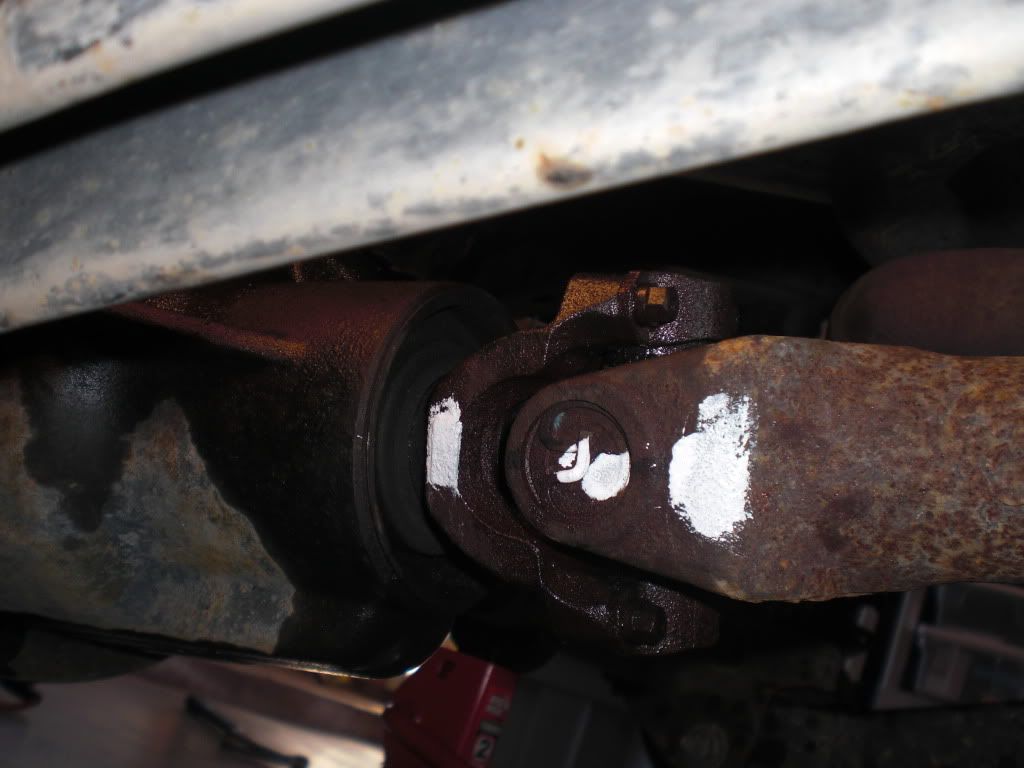

Next, I removed the straps that hold the front drive shaft to the pinion yoke. I must admit, I'm not sure this was the right move. The maintenance manual says to remove the drive shaft (actually called the propeller shaft for who-knows-why). Disconnect it at the yoke and the transfer case. I'm thinking I can just disconnect at the yoke. We'll see.
Even with the straps removed the shaft stays in place (the strap is really blurry in the picture - sorry). I'm thinking that after I disconnect the axle I can swing it forward and away and the shaft will swing loose. Or I'll bite the bullet, remove the skid plate, and remove the "propeller" shaft.
BTW, I marked the shaft and yoke with white paint so I can put them back the way they came. I'll be less generous with paint next time.

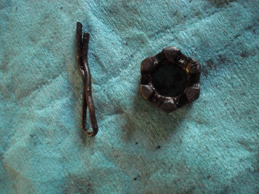

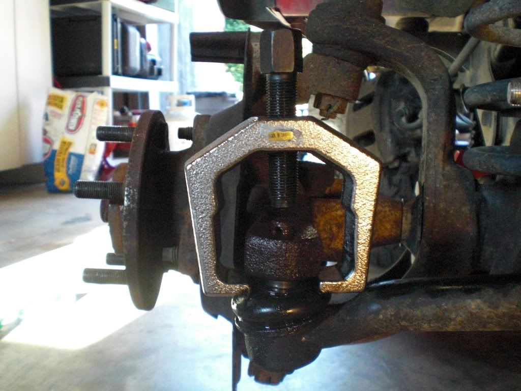

Next I tackled the drag link and tie-rod - drag link first. This didn't go so smoothly. First I removed the nut. The nut is notched and you use a cotter pin inserted through the bolt to keep it from working loose - you get the feeling these oughn't accidently come apart.
Having done that, the darn thing won't come loose. There it sets, unbolted but stuck. I tried persuading it with my BFH to no avail.
Now, the jeep service manual suggests using one of those special jeep tools that don't have a name, just a number like 4192A - remove tie-rod using 4192A - but it looked like something I had seen at harbor freight. So, a quick trip to HF and I was able to push the darn thing free.
The HF tool was called a pittman arm remover (or something about pittman's arm), but it looked about right and it got the job done.

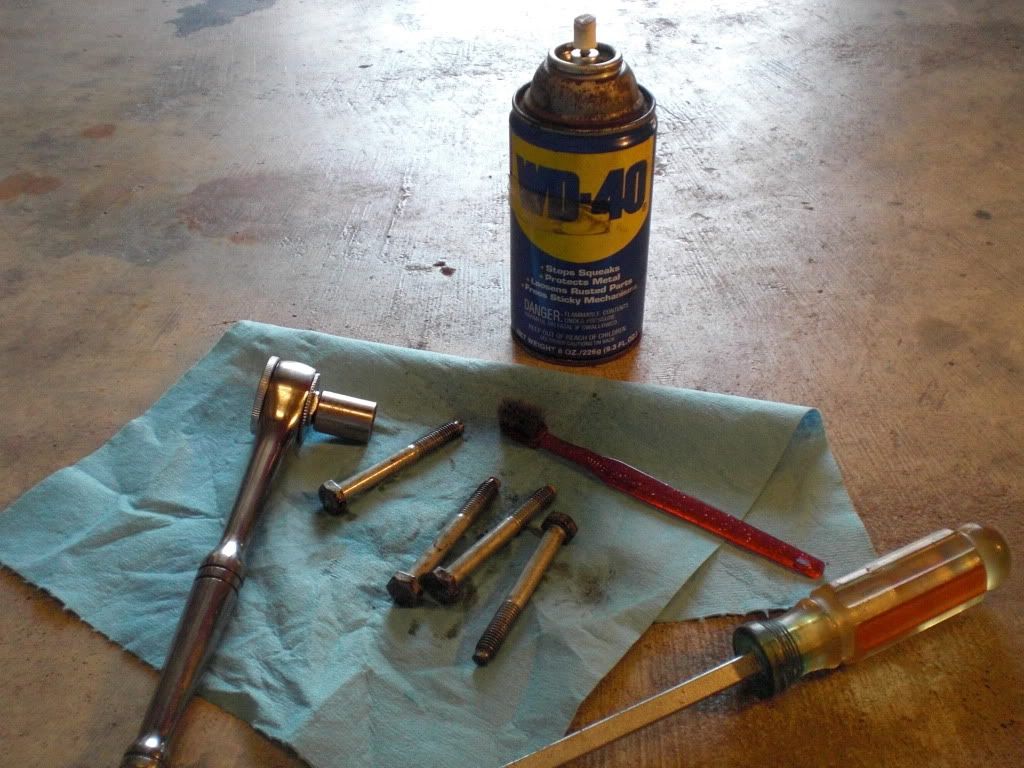

I developed a habit of cleaning all the fasteners. They are, many of them, quite diry & corroded. Anyway, I give them a good bath in WD40 and clean the threads with a toothbrush. This is probably bad for some reason, but at least they go in the baggies clean. Gives me flashbacks of MCRD San Diego, though. I think it's the toothbrush that does it.
