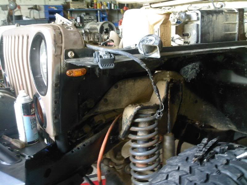

they measure shocks odd, my trail master shocks are way to short for my lift, i only have maybe 4" of down travel, this pic the jeep is sitting level
