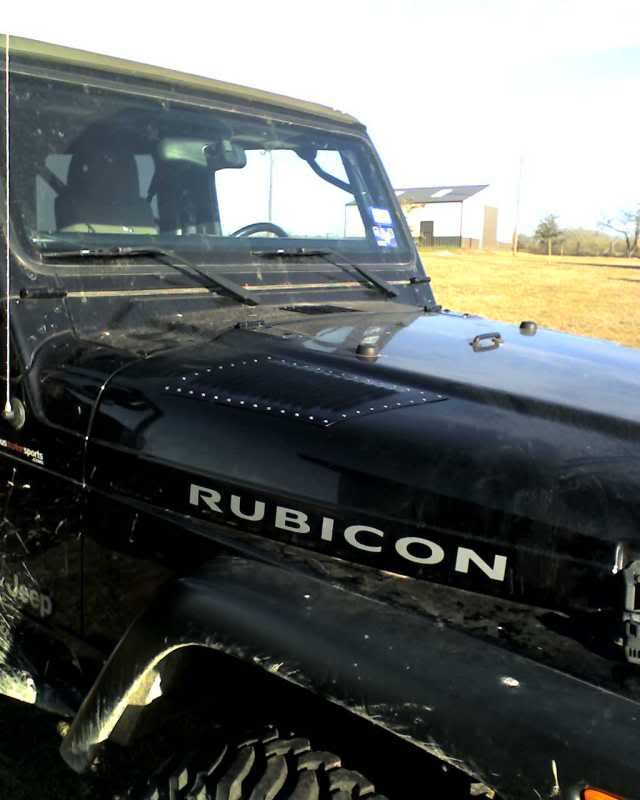

heres my CAI it uses the factory air box and paper filter
