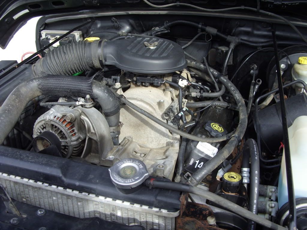

I used a 5.2 from a 98 Ram pickup. Advance Adapter motor mounts put the 5.2 and 46re auto in just the right spot for stock driveshafts. Front half of the Ram exhaust with rear of TJ exhaust with a little tweaking. Dakota air bonnet and hose with stock TJ air filter box. Ram power steering pump and pressure hose and TJ return hose. Right now I have an NV3500 5 speed from a 96 Ram but liked the auto better and am changing it back. Stock skid and made a trans mount from half the Ram one and half the TJ mount. Used a shifter and cable from an XJ, $10 from pick a part. Throttle cable from Ram fit perfect.
Get the FSMs for both the TJ and the donor vehicle and it's pretty easy to do the harness yourself. I'm still using the stock 4 cyl rad. No cooling issues yet, even in 45C in the desert last summer....
Also, I did this swap in one long weekend. Sold the 4 banger and trans and am up a little cash

That craddle looks like it would fit the stock TJ AC compressor! That would be another bonus

I have a stock A/C compressor on there now for on board air....but it was from a ZJ. Not sure if a TJ one is the same mount....
