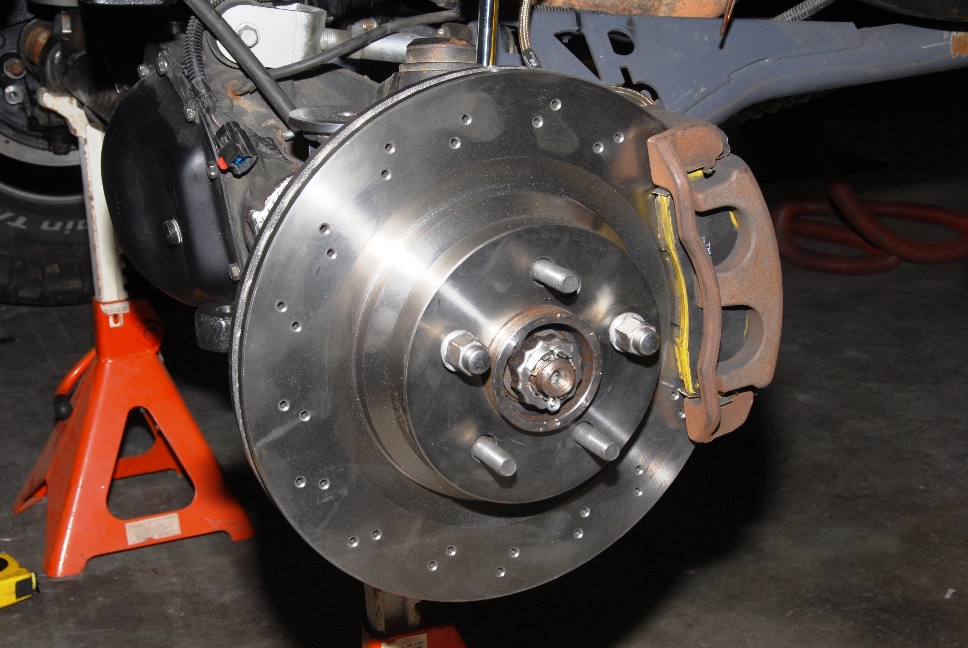

Just a small tidbit for your viewing pleasure. We started development of this kit exactly 10 days ago from scratch.
13" rotor from an 05 Mercedes, 01 Ford Explorer 48mm dual piston caliper with the EBC Yellow Race/Street pads adapted onto Van's modified stock TJ knuckle.
