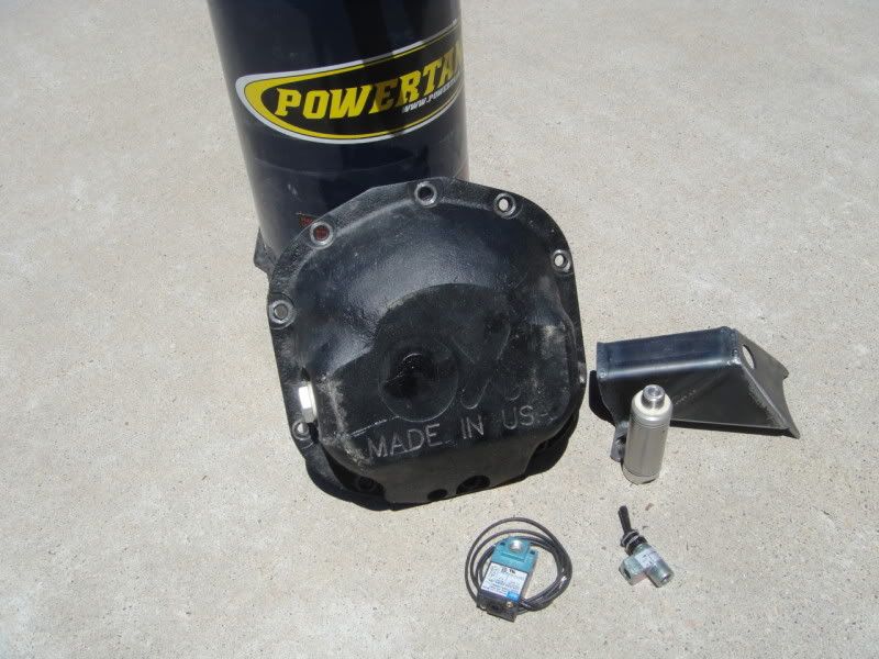

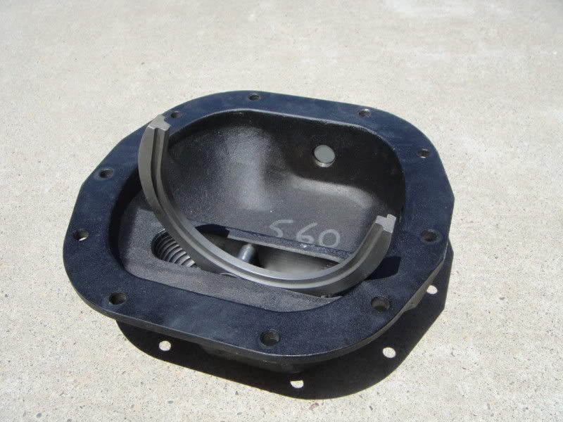

OX... Bullet Proof cover, no compressor, simplistic actuation, nothing internal and no cable or shifter if you don't want to.
Air Piston $12
Air switch $8
Electric/Air Solenoid $20
Skid for Air Piston custom
Instead of the air switch (more simplicity) you can use the ARB-type Solenoid to be really creative in mounting options (no airlines need to come inside to the switch).

Yeah, thanks for the picture above on the OX setup. I know the kit comes with a nice new pumpkin cover, which will be beneficial for me since its going in the front on the new HP30. How much does the kit cost to convert the OX locker to electronic actuation? If I could use a factory switch(Like the Rubicon's) to actual the front OX locker I may just go that route Link?
