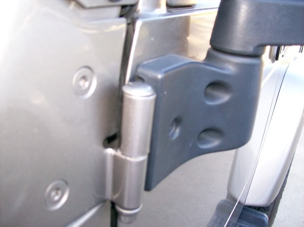

One other thing, on that same door, jeep may have been wrecked, I dont know, the door hinge itself, the one that connects to the rear view mirror, looks bent out a little, thus making the top of the door frame not fit tight against the jeep. In looking at the door and the front quarter pannel, the door does stick out. Any idea on how to bend this back in a little?

here is a pic.

I have an uncle that straightened some body parts for me once using a series of huge pipe clamps, and positioned it around something solid and just kept cranking them slightly and it worked, but I've never tried this myself. You'd need to remove the door, and everything again, glass too.
