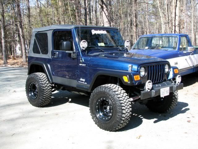

These are the MCE Fenders
[Edit by Jerry Bransford: ]
