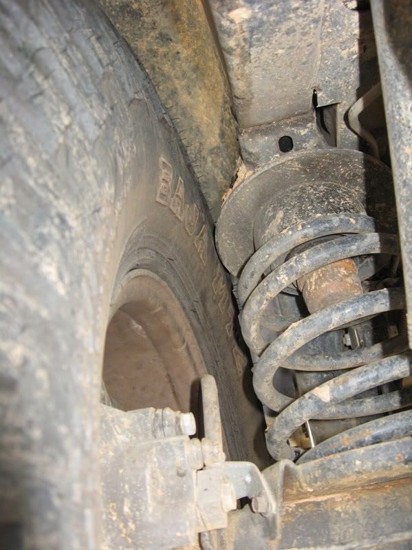

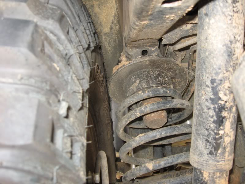

While a buddy and I were looking under the jeep I noticed how narrow of a gap there is between the rear coil spring cup and the inside edge of my tire....
There actually is a gap. I tried to take two images to show it. I don't have photo shop or I would have added an arrow.

Is this dangerous, or does this require immediate attention?

looks a little too close for comfort but i guess if it hasn't been rubbing its not too bad...If i were you i would space out your tires a bit.

Is it the same on both sides? Since your profile lists a 2-inch BB, I'll bet your axle is shifted to one side. A track bar bracket, or an adjustable rear track bar if you want to spend that much, should center the axle. That would increase the gap you are looking at, by making the gap on both sides approximately equal.

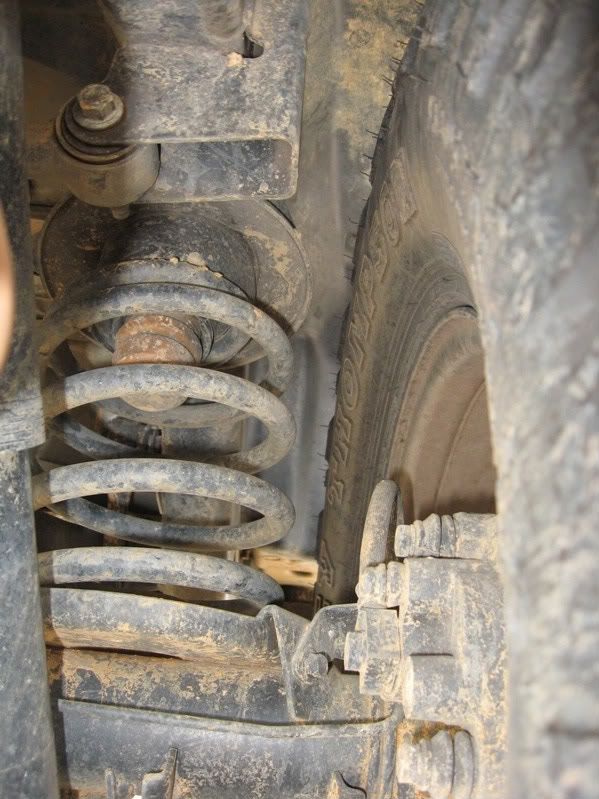

You know...I have read about the shift and never thought it happened because my jeep looks fine to me, but.....
Left side...
and now....drum roll please....the right side...

Looks like you need an adjusable track bar.
As far as spacers go, if you get the ones that actually bolt on to the axle, they're completely safe. The "bad" ones that people talk about are the shims that just go inbetween the wheel and spindle, causing the lugnuts to have less threads holding the wheel on. Those are in fact very dangerous.

Because the trackbar bolts to the axle on one end and the frame on the other - so when you lift it's like opening a pair of scissors. The trackbars pull the front to the drivers side and the rear to the passenger side.
Lay a pencil on a table. Lift one end and you see that the other end that's still on the table moves towards the end you are lifting.
Jim
To the OP - you can grind a bit of the edge of the spring perch off but you really need an adjustable trackbar.
