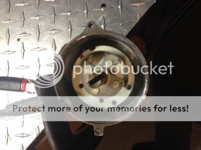

been sitting about 2 years previous owner broke a cap bolt off in the distributor and left it.
Am I missing something here?
Cap, Rotor, and pick up coil I have but are not installed in the photo.
I have searched high and low on the internet and can not find a good picture. Looking for someone that has done a tune up on your TJ am I missing anything from the distributor? I bought this Jeep used, the PO had removed the distributor so I do not know right off what was in it.I replaced the coil as it was bad.

I don't see the camshaft position sensor (see illustration)...
INSTALLATION
(1) Install camshaft position sensor to distributor. Align sensor into notch on distributor housing.
(2) Connect wiring harness.
(3) Install rotor.
(4) Install distributor cap. Tighten mounting screws.

My mistake I was calling the cam shaft position sensor a pick up coil. I do have it. But hey great info just what I needed.. People like you are the reason I love JeepForum.com

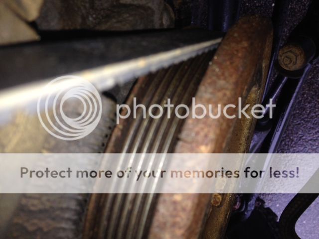

So with out adjusting anything I got the harmonic balance mark on 0"" and pulled the #1 plug to ensure TDC, and marked the distributor and pulled cap hoping to see the rotor way off as that would be a easy fix but. It looks to be almost dead on. What do you guys think?
Crank timing mark
Distributor, you can kinda see the scratch mark I made to mark the location of the #1 plug wire.

Autozone loan a tool has a pressure test kit. I am going to grab that and test pressure. Looks like timing is straightened out.. I can remember a time when I was working on autos for a living and said enough got some education and joined the Coast Guard... Now I remember why I quit working on vehicles. Engine rooms on boats are much easier to work in.
