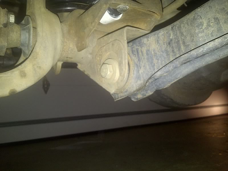

On your 2004 the stock control arm bolt will be centered in the washer (non adjustable). After installing the cam bolt orientated as in the photo (maximum adjustment) take it for a ride and see how it feels.
When you lifted the Jeep you increased the angle of the control arms effectively decreasing the caster from the stock setting. This 1.5 increase should get you back, close to where it was.

Location: Greenwood
Posts: 1,538
I just snapped this pic and I can see I do not have the adjustable type.
So by fixing this I will add more weight to the steering, and make it handle and drive better but will this do anything for the shimmy in the steering wheel.
