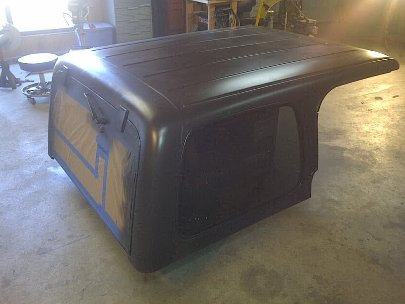

More of the top after finished painting..
I think it turned out pretty good..

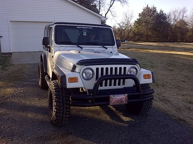

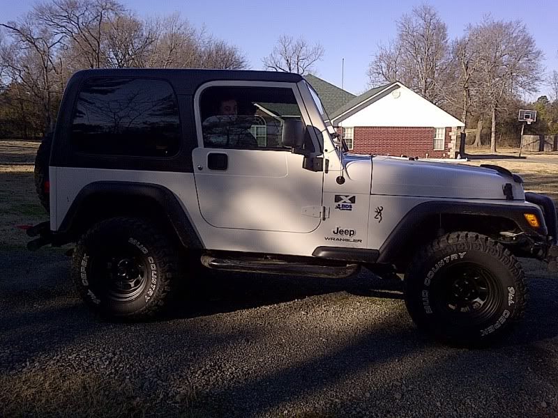

BrowningGal's Jeep After Lift, Tires, Wheels, Brakes, Painted Flares and Painted Top.

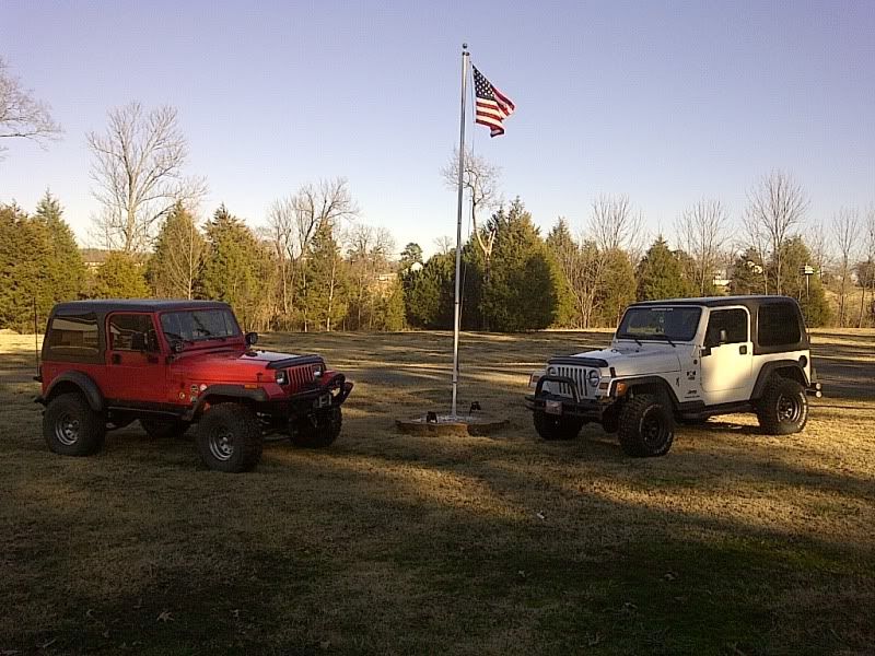

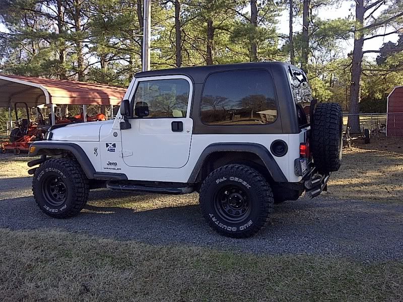

Comparison Pics...
Before the work was done..
After Work Was Done
