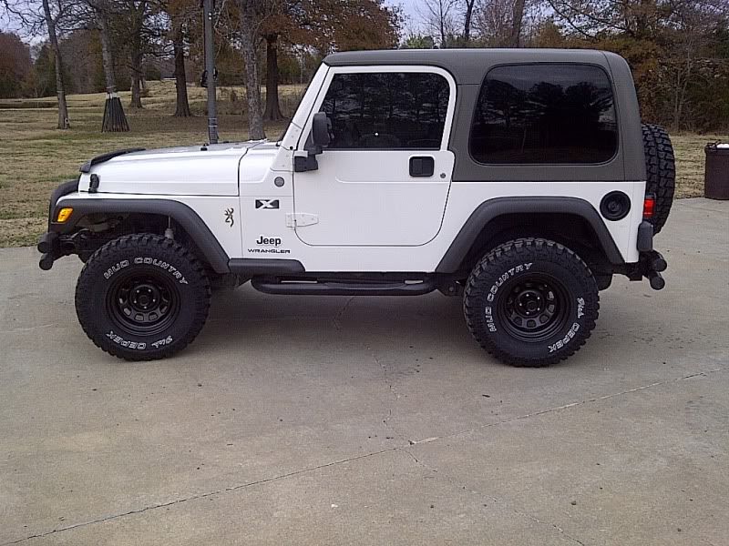

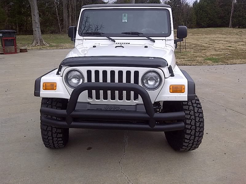

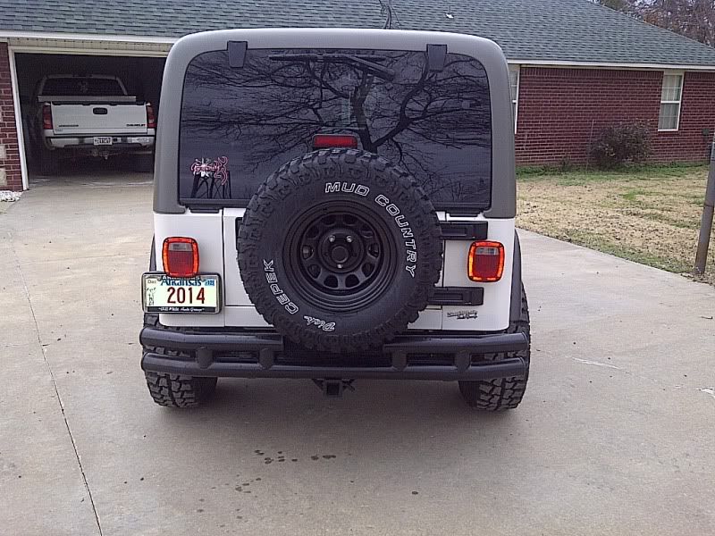

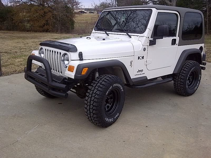

Ok here are the pics in the daylight after we cleaned it up a little bit this morning.
Having one small issue, it seems to want to pull to the left just a little when driving. I did an alignment but I think I need to check it one more time. how much toe-in should I be looking for. I was going for 1/8"... Would anyone suggest a little more or less.. I don't see how that could make it pull left but something is a little.
Other than that it is great, the 3.73 gears seem perfect with these tires. Not a speed demon but you could pass someone if you wanted to.
