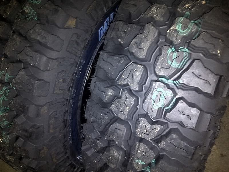

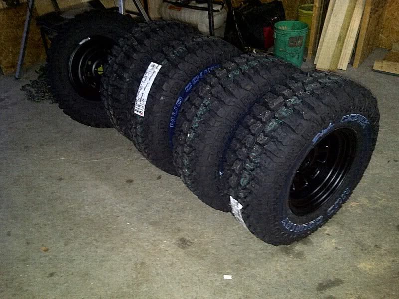

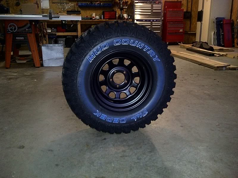

Tires and wheels are here...
They seem to have some good meat on them... I picked these tires because of all the tires I looked at and read the reviews on these seem to have the best reviews for mud, snow and Ice... I know they are not made for ice but they still carried the best reviews for it..

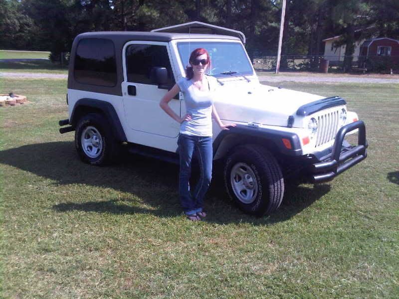

Pic of BrowningGal's Jeep as it sits today!!
Measurement under driver door, Stock!!
